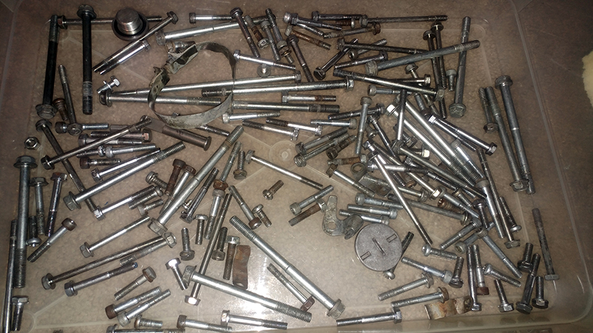

A bunch of crank case bolts off eBay. Some extras including a full set of beautiful cylinder head nuts! Very happy. Next sorting them out by thread and length.

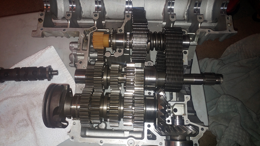

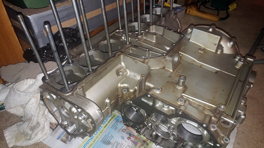

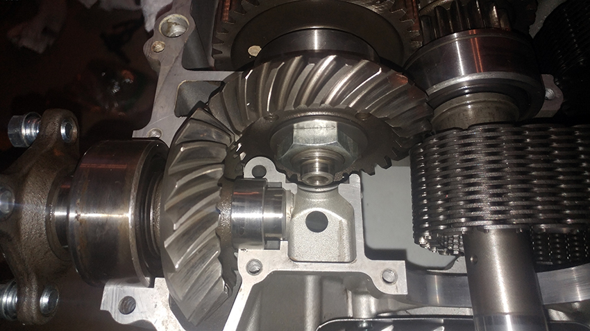

Very quick mock up of the gears and lower crank case, for reference. Especially that I haven't seen any detailed close ups of these. There will be more detailed images later, this is just a 'quickie'.
The crank case is still going to be cleaned, and probably painted and heat treated with silver color this time as there is nothing attached to it so easy to heat treat. The journal bearings are removed - it's an empty shell.
1980 transmission with 18k miles.
From top to bottom:
From top to bottom:
- SECONDARY SHAFT
From left:- 1 oil pump gear drive
- 2 water pump and cam timing sprockets
- 3 second driven gear and the primary chain
- 4 second drive sprocket and secondary chain. This is the only shaft in the gear box having journal bearings at each end (1 + 1)
- SHAFT DRIVE - connecting on the right to the clutch assembly with a secondary chain. Sits in the crank case cut journals, has two bearings.
From left:- 1 2nd gear
- 2 top gear input
- 3 3rd gear
- 4 4th gear
- 5 gear on the shaft connecting to the low gear output shaft (next)
- 1 2nd gear
- INNER DRIVEN SHAFT
From left:- 1 cam damper
- 2 cam follower
- 3 2nd gear driven shaft
- 4 top gear output
- 5 3rd gear driven shaft
- 6 4th gear output
- 7 lower gear driven shaft
- 8 set of front bevel gears connecting to the output shaft (cardan)
- 1 cam damper

thanks for the pics Stan. McBoney should look at these. There's really not much in there to have to "disassemble" to change out the primary and secondary chains. Really only 4 major components to deal with. How long to assemble those parts Stan?? Les than a minute right?
The topic has been locked.
I've been editing this post probably 55 times, haha Trouble with the code, control bold etc. boxes disappear, no colors for different tags, no line breaks... ahhh! But I got it somewhat readable right now. Sometimes it's good to fall back on the old times hand on coding experience. Otherwise it would be a total mess.
I posted it specifically thinking of McBoney at the moment. You are right - except for the gear changing mechanism that will go underneath, it's just these four. It did take a bit longer to put it together though..... - about a minute and 15 seconds? hahaha :woohoo: I am hoping to inspire McBoney to take a shot at this.

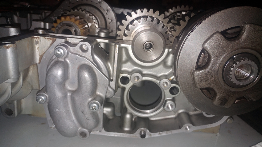

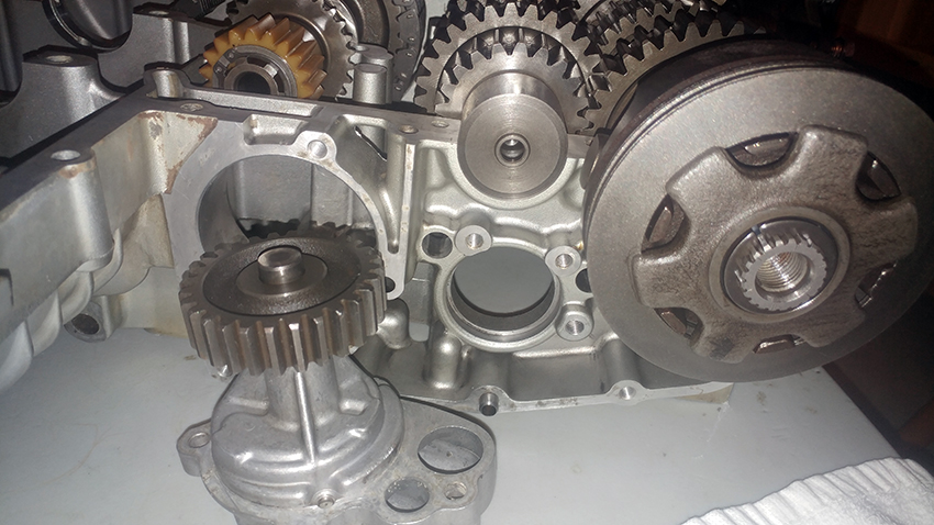

7 years 11 months ago - 7 years 11 months agoOil pump - simple removal and install.

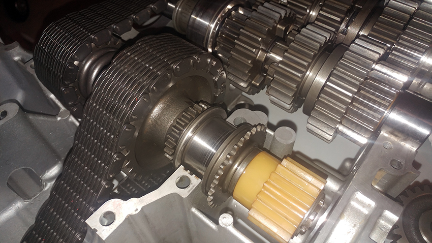

Oil pump driving gear. From the middle - main chain, camshaft chain sprocket, water pump chain sprocket, and the yellow nylon oil pump gear.

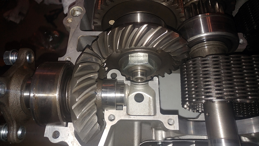

Output to the cardan.
