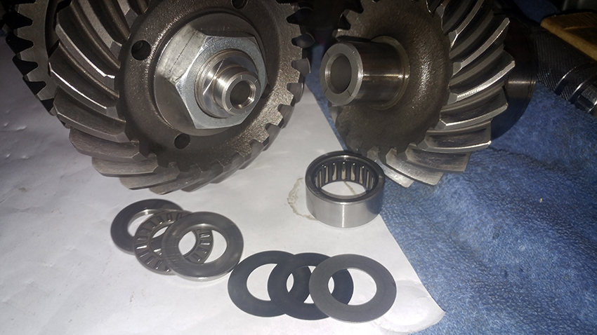

Inner driven shaft needle thrust bearing and shims quick reminder: smaller diameter inside (towards the gear), larger outside, (lettering goes outside of course), closed face of the bearing inside, open face out, fine tune shims and a the thick stopping shim last to the crank case. (not sure what the proper names for these are but works for me).
Before installing double check the gears alignment for proper contact. They are all part of the same set, but perhaps some minimal crank case differences will need to be addressed.

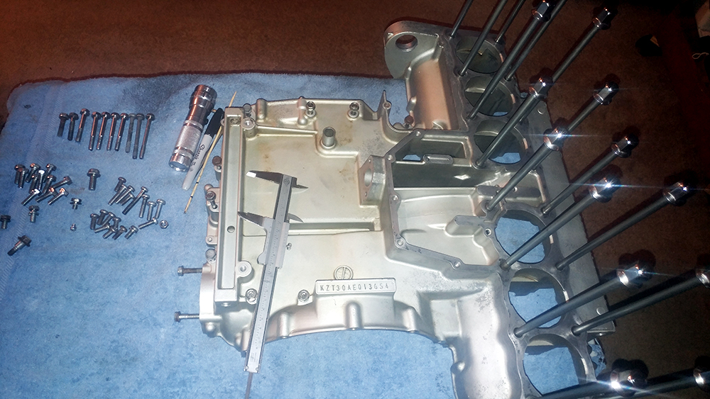

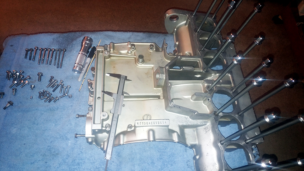

After rough sorting out the bolts and pieces bought in a plastic bag, time to really find their places.
99% success! Got enough bolts to match almost every size and placement. All in great shape, but everything will need final cleaning, and I will chase all the threads as well.
Feels fun doing this! And what can I say... size does matter! :woohoo:
