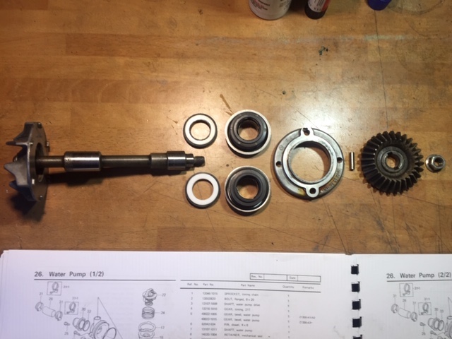

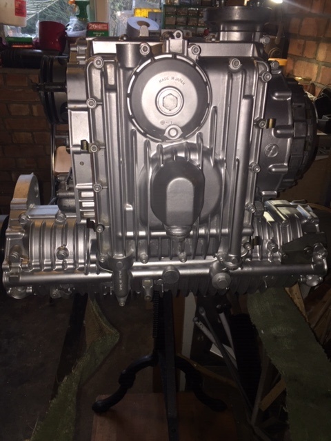

Mechanical seal and oil rotor came in the post today so I re-installed the oil pump as well as the water impeller shaft.
Everything sealed with copper-based sealant and lubricated with Assembly oil (which btw is the greatest hand moisturiser ever!)
Water impeller: new and old seal:
Then re-installed the oil pan - what a difference with when it came off!
Before:
After:
Now going to the shops to find an aggressive paint stripper for the one case that needs re-doing for the 4th time! :S
Before:
After:

Nice progress Paul! I bet you're glad now you decided to open up the crank case yourself. It's almost done!
Is your kitchen on the same floor? If I'm not mistaken the engine is back in the garage. How did you transport it there and back?

Yes, before I realised that this website had all the parts list etc. I bought an A4 sized parts booklet from a guy in Oz on the web. They guy did not want to sell me the files so I can't post those, but happy to send you a physical copy, just let me know.
It is not the manual, I found that line and printed that out as well - I find reading from paper easier - but I find the parts diagrams quite helpful to see what needs to go where.
