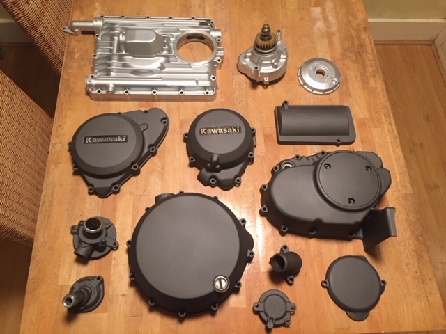

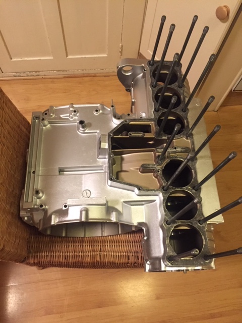

Ok, cases came back pretty clean, but some more paint flaked off, so will need another going over with sanding paper.

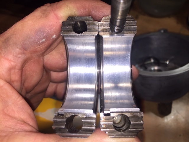

Crankshaft also looks fine, but the guy still wanted to see what the big end bearings looked like. So, following Kawboy's advice, we took the third con rod off. After a slight wipe with a cloth, the bearings look like this:
Thoughts? He thought they were fine to put back in.

They look fine. The Babbitt that is on the shells can vary in thickness but generally speaking is around .010" thick If there's a problem Like low oil flow, the Babbitt can melt and you're left with bare spots on the bearings shells (which generally are copper) If the oil was contaminated with particles which made it through the filter if the filter got plugged and went into bypass mode, you would find particles embedded in the Babbitt and scoring on the journals. So things to look for are the particles or bare spots on the bearing shells revealing the copper (or sometimes aluminum)
Usually wiggling the con rod on the journal side to side will be a strong indication of an issue or not. There will be movement, but just enough to feel and very little to see. When the rod bearings fail, they really fail due to the reciprocating motion of the assembly. The mains on the other hand are tougher to feel and Plastigage is really the only way to identify a problem Unless you did a oil pressure test before tearing down the motor

Kawboy, as usual, you are spot on and I am also of the 'preventative maintenance' half of the population (the other half being: when it goes wrong we'll fix it) and I also firmly believe in engaging brain before action.
However, you forget; this engine was seized solid with rust on every valve stem, so a pressure test was out of the question and even thinking about a leak down test was wishful thinking. I did have a piston ring issue, as in: they were fused to the bores to such an extent that it took month to get them out and after that I had to get a new block. Of the five plugs that came with the bike, only three were screwed in properly and all were coated in grime and rust coloured. :ohmy:
Considering all that, I question everything that I encounter, and you kindly provide the answers (thank you!). In this case, based on your description and my conversation with the engine cleaning guy - who also felt the side-to-side movement and said that felt well within spec - , I have no reason to doubt the condition of the rest of the bearings and rather than spend a great deal of money and effort on new ones, I will go with them as they are.

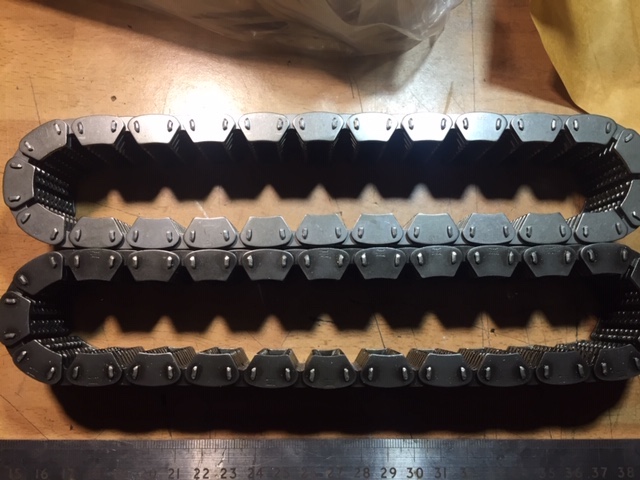

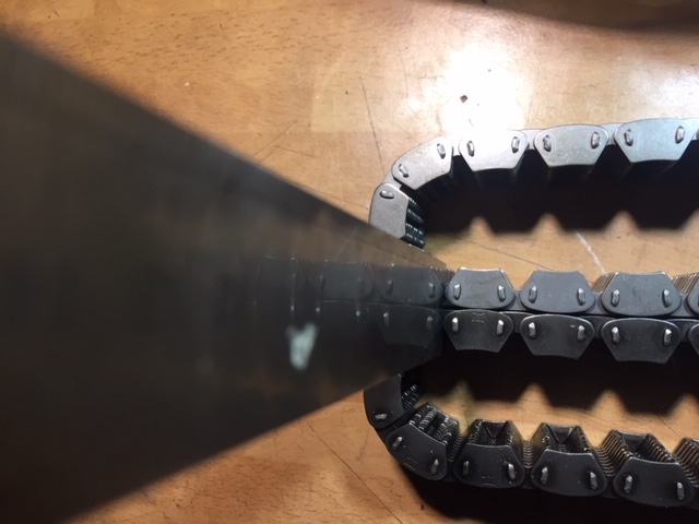

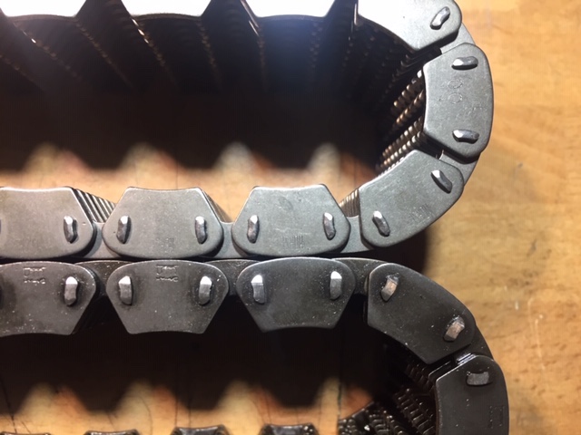

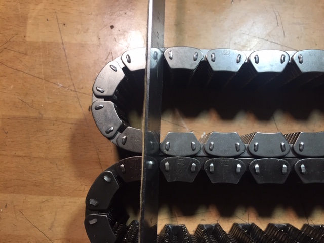

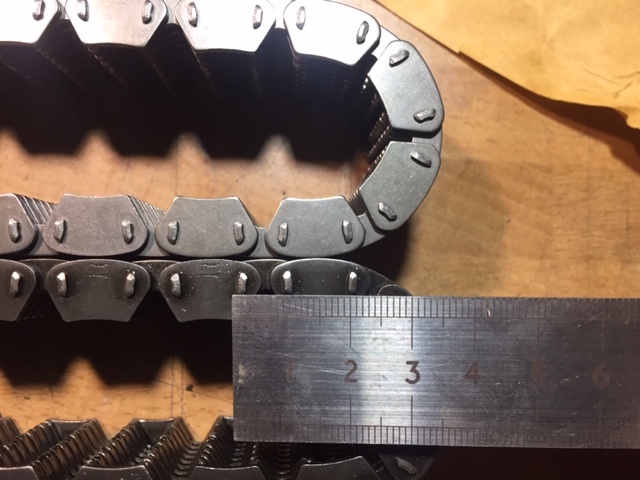

Paul, when you have a break waiting for the paint to dry, haha, could you take a couple of measurements?
You have both old and new primary and secondary chains. Could you measure them in the same manner as the cam chain is evaluated? Theses are more rigid and shorter, but maybe it would be possible to compare the lengths. And your chains are a perfect scenario - for both you have brand new, and old just exceeding the service limit.
Hi Stan,

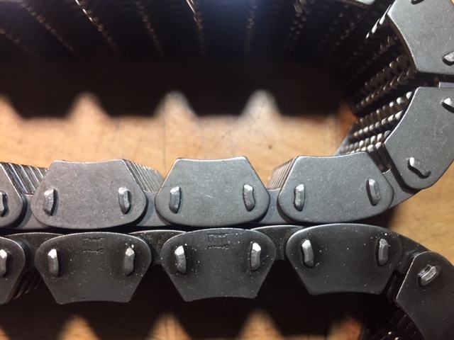

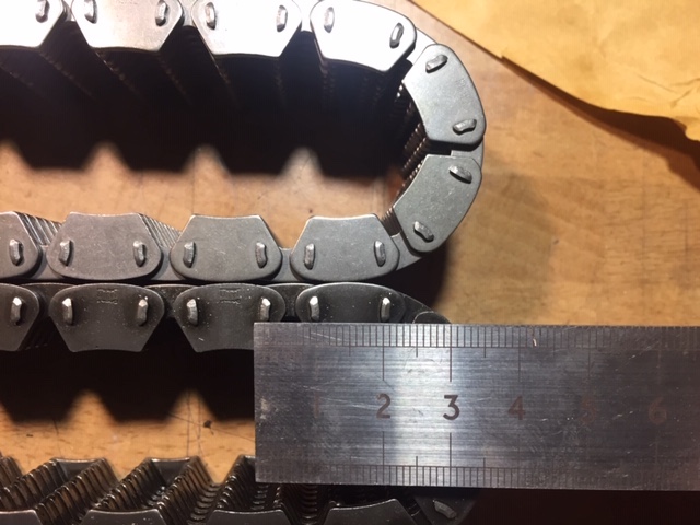

The difference in length is virtually imperceptible. The new chains feel stiffer than the old ones and flex slightly less, but other than that they are very similar. There is a length difference, but it is very slight. I could only see it by lining up two links with a metal bar and pulling the chains straight, then at the other end you can see a very slight length difference. Top ones are the new ones.

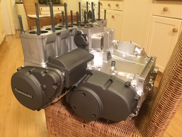

Paint is dry!

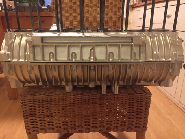

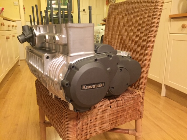

Looking nice I think, but the grey still needs clear coating to get the gloss and the block still needs baking.
Also, I couldn't resist doing a quick mock-up...
