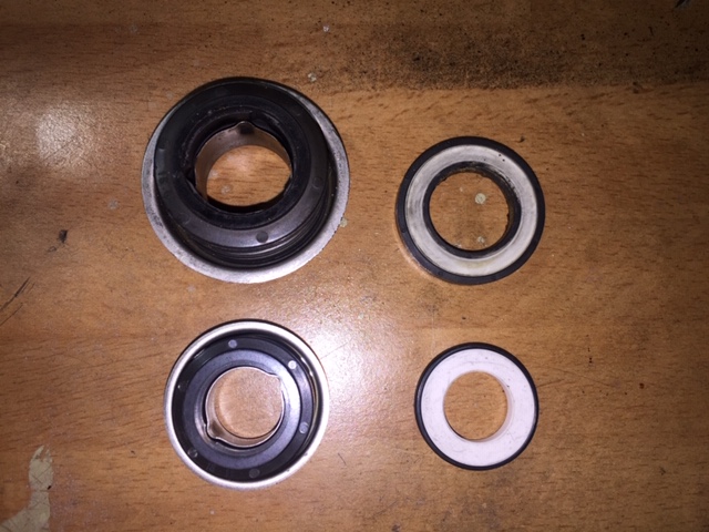

Grrr!
Mechanical seal for water pump. Old one at the top, new one below.
Wrong size!
Note to self: measure and make sure before ordering!!
Wrong size!

That's too bad Paul. Sorry to hear that.
Since you are a new face around here, you may not know my little secret about using www.Partzilla.com as a look up tool. Simple enough. Create an account and then use the site. You can find part numbers for all power sport vehicles there.

it took me 5 times longer to cut and paste this info than it did to look up and figure out why the seal was the wrong size. I just think this tool is great for figuring out what parts are transferable between the ZN and the Z and the KZ 1300's In this case, I figured out what that part actually fits. Maybe you can advertise the on a local site and recuperate some of your costs.

I'd suggest to stay with genuine Kawasaki parts when it comes to crucial components, unless proven good quality aftermarket. I got my mechanical seal from Kawasaki dealership - they actually had it. Also, when the time comes, although expensive - I'd get a genuine Kawasaki head gasket. At least here in Canada they have it.
