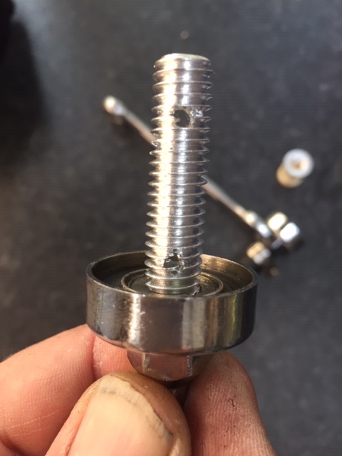

Thanks, I took the filter apart and it is immediately apparent that they are inferior. Look at the metal 'shrapnel' just waiting to break off and go into the engine! I drilled them out and got rid of all the loose bits, and as I have nothing else yet, I stuck it back on - for now.

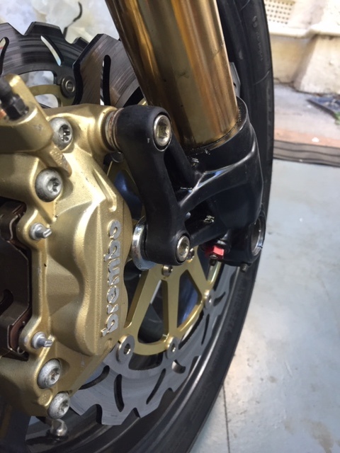

So I finally managed to get the front brakes to work. We were all wrong. The issue was that the offset between the forks and the calipers was too great and the pressure pushed the RH pistons in so far that they could not seal, I found out by putting the caliper on a table higher than the MC thinking the air would drift up, but forgot to put something in between the pistons. So the pistons closed all the way and he presto, pressure!
Then I put them onto the bike and pressure gone again.... grrr...anyway an hour later and it becomes apparent that when I tighten the bolts attaching the calipers to the forks, I lose pressure. A few washers later and we are in business! ... Pfff Brembo prima-donna stuff!

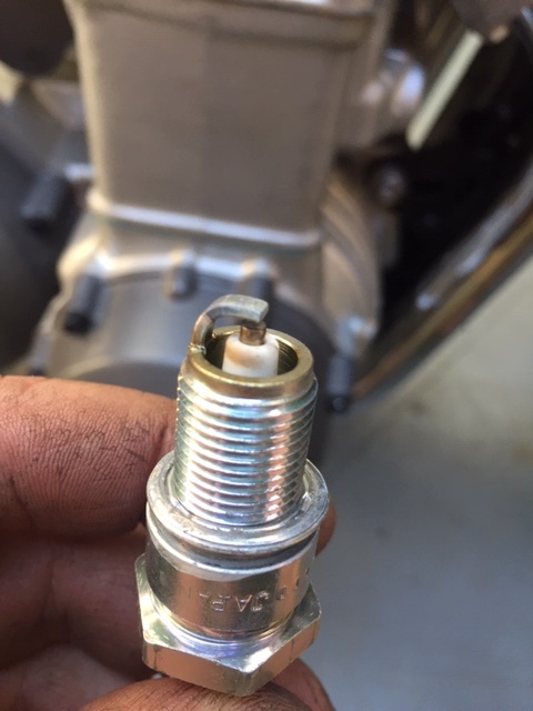

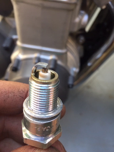

I also took the spark plugs out to see what mixture I was running. One was black (so a little rich), two and three were nicely coffee brown and white, four five and six were as per the pic. I think the last three are a little lean. So I will turn the screw for one out by a half turn, and in for four to six by a half turn. Then go for another run tomorrow. Hope fully the balancing kit will arrive end of this week, then I can set them up properly.

Agreed,
The quality of that type of Petrol Filter is not the best, but I have had one fitted to my current Z1300 with no issues what-so-ever and covered nearly 2000 miles including motorway runs at over 70 mph for 300 miles.
I have also fitted the same type of filter to other Z1300's in the past without issues either but only after checking the "flow rate" from the tap to the carbs in the first place.
The benefit of this type of glass filter is that you can actually see the condition of the fuel and if the filter needs cleaning.
If you had fitted a "Blind" filter, you would not have seen the issue you had with the discolouring earlier ??........food for thought ?

Can't dispute the intrinsic value of "seeing" your fuel. And in the examples pictured, where the filter is visible - certainly. The 2-pack I bought - once - one would not reassemble straight (Parallel) so it leaked and the 2nd .....couldn't get it apart ! I put that down to nothing more then the crappy thread machining. And I use the term "Machining" ....loosely !
My filter location doesn't provide a clear (no pun intended) view, so that point is moot, for myself. With the WIX - I back-flush it once after 1 year of use - after 2 years I replace it.

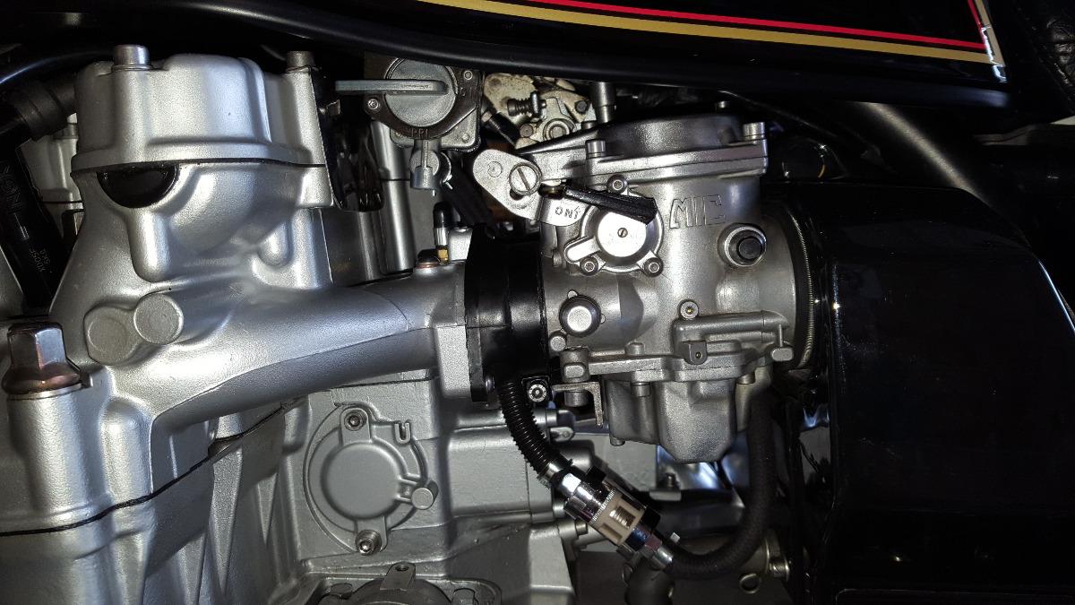

Right, I managed to get the carbs set up reasonably well (thanks for the phone assistance Pete!) and the vacuum is the same across all carbs (but only 5 inch). I still need to adjust mixture and my Colortune kit is coming next week. And then maybe mess around with the fast idle and choke etc...
I took it out for a five mile run and it seems to behave. Only thing I notice is lack of power at low revs, which I think is mixture related. I didn't want to go high revs as its still running in, but overall it does what it says on the tin. It idles, runs, goes fast when you need it, goes around corners OK and stops fine.
