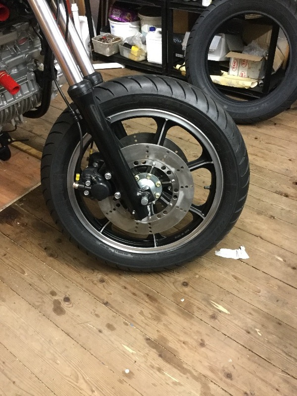

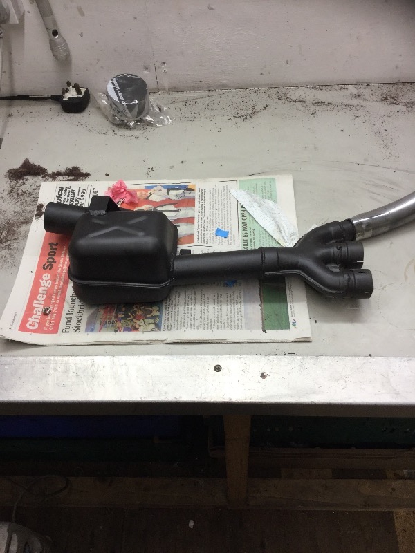

A bit more progress this week with the front wheel painted and new tyre fitted. Brake calipers installed and all bled. Surprised how easily they bled as I’ve had problems with other brake systems I’ve restored in the past. Was going to fit the exhausts tonight then remembered I’ve forgot to order new seals for the exhaust header to collector box. Hopefully they’ll come before Christmas. Decided to have the collector boxes ceramic coated. That should keep the rust at bay for a few years.

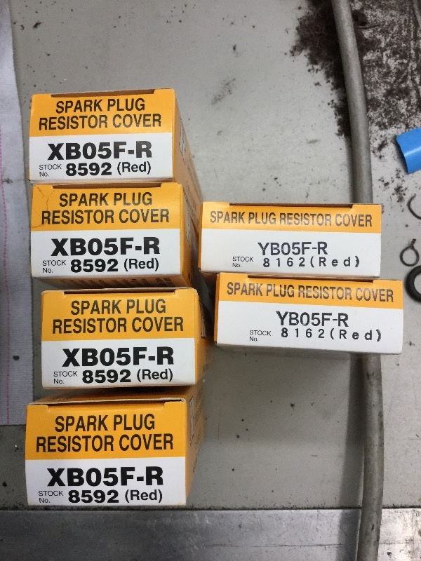

mizztheman - which plugs did you use on cylinder 3 and 4? 1 and 6 is the short type I see, and 2 and 5 long.

I used the longer plug caps for cylinders 2,3,4 and 5. Here’s some photos to show you how I’ve done it. You’ll notice that the plugs caps for cylinders 3 and 4 are quite close to the cam cover but if I shorten the HT lead by about an inch it will give more clearance. I don’t expect any issues with them being that close.

The front wheel and fork etc. looks great. Which make / type of tires have you chosen?
The ceramic coating on the exhaust collector looks good too. I've just started reading up on the process. Seems you can have different types of finish - I wonder if it would be a good choice for the cylinder block and head.
