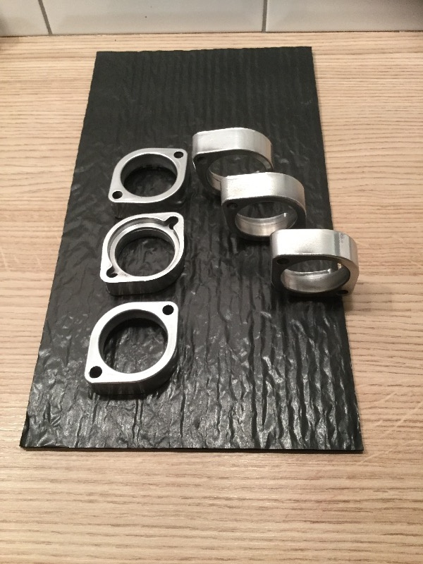

The company I use for ceramic coating is here camcoat.com/main/
They have many different colours and types of finishes including cerachrome. Have a look at their picture gallery showing its use on engines. I’ve had the exhaust collers polished and clear coated in a ceramic coating. I’ll post a photo later.

mizztheman, thank you, that's great info and the photos make it so clear to me!
I will have to source these things locally on the other side of the Atlantic. It will take me one more step towards the spark in the engine. I am also convinced about ceramic coating the exhaust collectors as you did. Dome once properly and they should last much longer. Lots of salt here on the roads in winter. I wouldn't probably ride much the KZ in cold weather, I have 'boat' for that (GL1100), but there is so much rain here and it always drip down to the pipes. my bikes sit outside, so it makes even more sense.

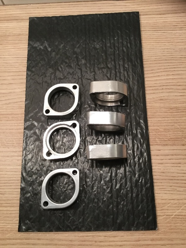

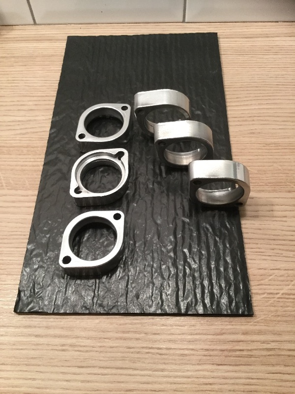

Here’s the photos of the exhaust collars which have been polished then ceramic clear coated.
Stan, I’m not too concerned about the inside of the collector boxes or the silencers and I’m not going to make any attempt to try halt the corrosion from the inside out. My belief is if the bike is used on a regular basis allowing the engine to get up to operating temperature and kept in a warmish garage then corrosion should be relatively slow.
I think if the bike is used on short runs and not not allowed to get up to temperature, you get condensation forming in the collector boxes and silencers which accelerates the corrosion issue. Climate also has an impact.
As I’m a summer rider I don’t expect this to be an issue. However, everyone to their own and you should do what you feel is right taking into account how you are going to use the bike and the conditions you are using it. Good luck with the restoration and keep the posts coming. I’m sure it’s providing loads of inspiration for others including me.

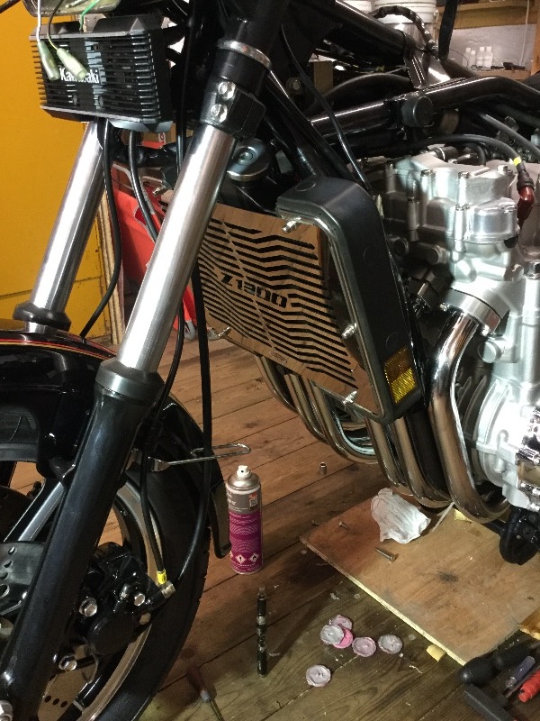

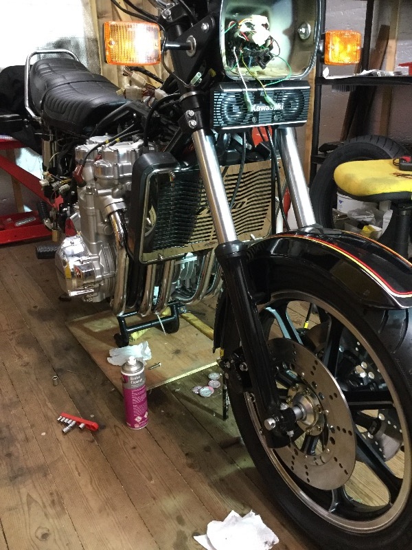

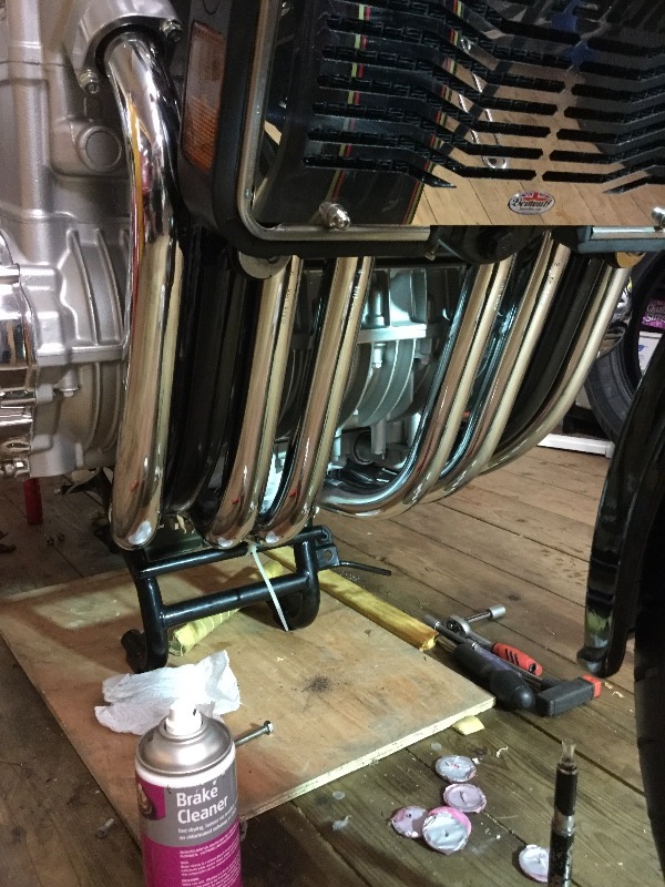

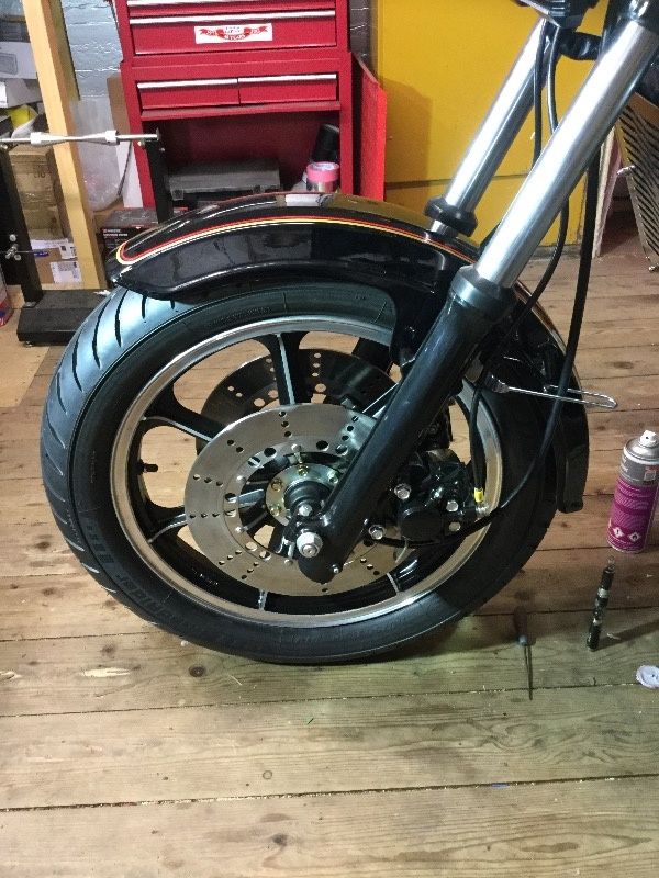

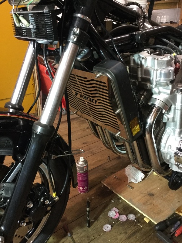

A bit more progress over the holiday but not as much as I would have liked due to coming down with some kind of virus. Anyway, feeling a bit better the last few days so decided to do a bit more on the bike. Exhausts fitted without too much of a problem and it was actually a shame to fit the radiator as it blocks the view of the six pipes which looks quite awesome without the radiator in the way. Radiator has been refitted along with new silicone hoses and new stainless grill. Radiator was painted satin black. That top clip proved a bit of a problem as if it’s not in the right position the clip catches the frame and stops the radiator from sitting correctly on the cushion. Was it me or the virus that had me struggling to locate it correctly. Probably the virus!!!!
Fitted the front mudguard which was painted by a local guy whose done other bikes for me in the past. The tank is also painted but in the house keeping warm. Put fresh oil in the bike and managed to spin the engine over to get the oil around what has been a dry engine for the last six months. Not quite ready to try and start the bike as there appears to be be a few electrical gremlins which I need to look at another day.
