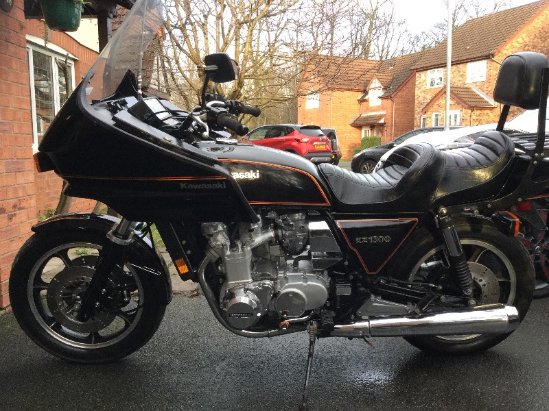

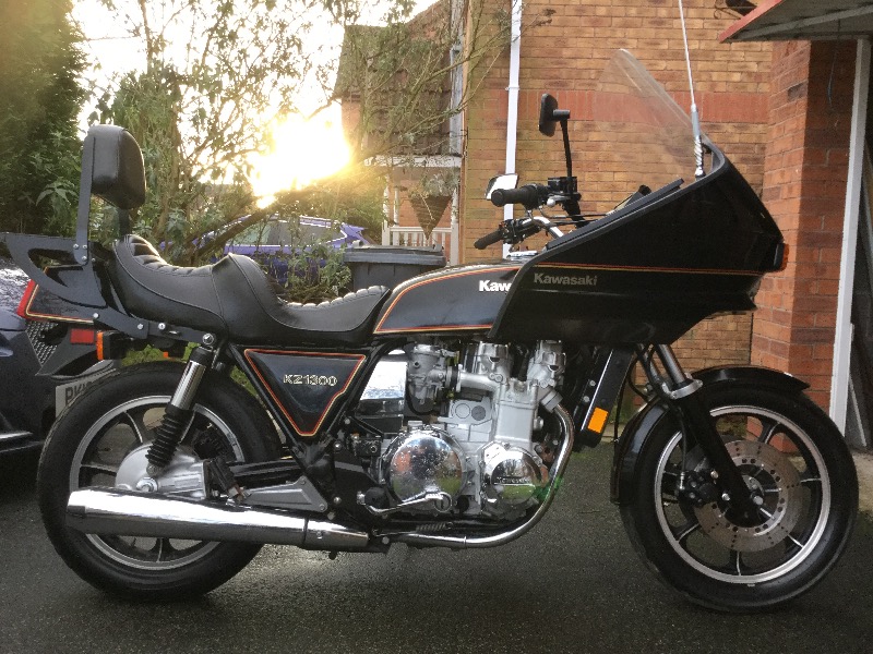

Looking better than new. Nice work !! Can't wait to see her with the tank on. Paintwork on the fender looks awesome. Just went back through your posts to find out what you did to the exhaust and I don't see any reference to them. They look new but are stock pipes?

Thanks Kawboy. The bike was imported from California to the UK and was in pretty good condition. The exhaust system is in good condition apart from light pitting and is too good condition to have rechromed. Ive had to rechrome the exhaust heat sheilds along with crankcase covers, rear wheel centre and a number of nuts and bolts. The main work to the exhaust system was to have the collector boxes ceramic coated.

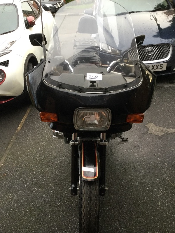

I’ve ditched the peanut shaped tank and replaced it with the more conventional style tank. Here’s a few photos of the bike when I first bought it.

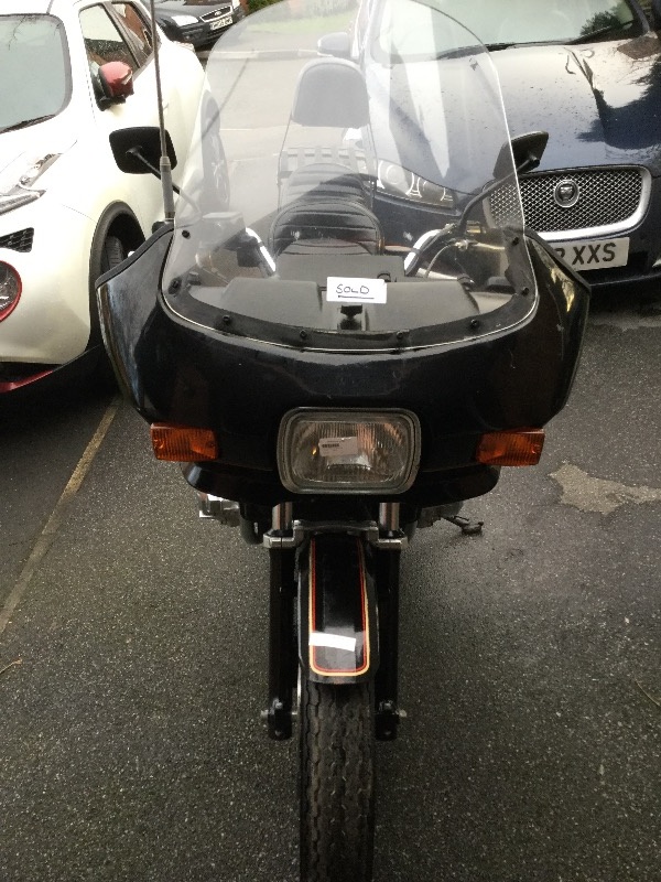

I must say, your work is producing great results. I love the views of the front wheel / fork etc., I've always thought the 1300 has a very handsome front end. Even more so when everything is nicely restored, like yours.
I remember when the 1300 was launched, it was often lamented that the view of the pipes is obscured by the radiator. Yes it is, but I would rather have the benefit of liquid cooling than the full view of the exhaust pipes! That radiator cover you've fitted looks superb too.
