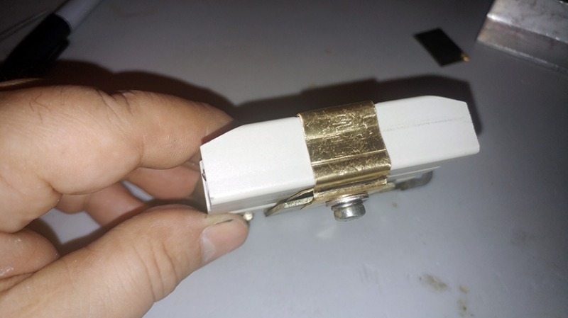

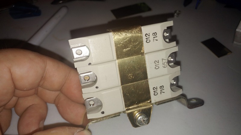

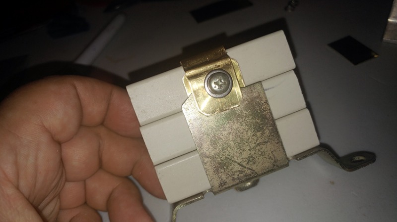

Done and secure. The back side first, third the face.
Once on the bike I will check for clearances from the tank, as they are a bit bigger than the OEM resistors pack, and perhaps angle the main bracket to increase the distance, as suggested by Neville in his excellent write up before. It's good enough for now to mount and connect all the wires, while the gas tank is being painted.
This is my take on the resistors mounting along with the AW82-TR1 coils. It is solid and didn't take much time to make. A bit of a steam punk approach, but works and gave me an idea of how I'd make a clean cut one if doing it again with proper tools. But this one works, so why would I want to make another one, unless bored in the future some day!
I might just go for it though because I am already seeing ways to improve this! :woohoo:
A couple of notches for a bit of top tension.

Just looking at your pic Stan and noticed 2 of the resistors are "012 718" and the one in the middle is "012 657" What's up with that?
Right KB, I had it all 'written' in my head and forgot to put it on 'paper' knowing it needs a word or two.Thank you for pointing this out!
The story is I got all from eBay, advertised as the same thing, but from two different vendors. I was going to get all three from one, but he had only two left. So the 'odd' one came from another seller. I was surprised with the numbers, which I have no clue what they mean. The brackets had a bit different colors as well, and while Beru have a 'made in Ireland' print from what I've seen on the web, these 'Beru' came as Bosh and made in Germany. I can settle for that, based on the BMW, Bosh and Germany connection.
I of course tested all three and they all test stable 0.4 Ohm after a few jumps from 0.3 to 0.5. Other than the numbers and that slight difference in the blue, they all look identical. I have no clue what those numbers mean, and at this point don't really care as they show the same numbers. But it is puzzling indeed. I have a few theories bouncing around my skull about this, and I have a plan to actually investigate it. There has to be a rationale behind this, and it could be just as simple as they came from a different plant, different batch, different specific destination as per these go for the this and those for that car model. No clue really... but a mystery indeed.
They read exactly the same, look exactly the same, I am turning a blind eye on the numbers as long as they perform. Now I have to shop for the little screws to attach the cables... Wouldn't you think they should be included? Damn cheepos! haha
