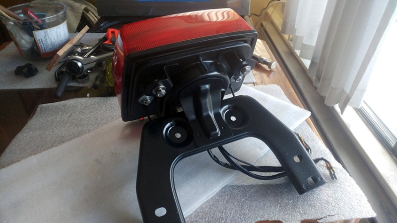

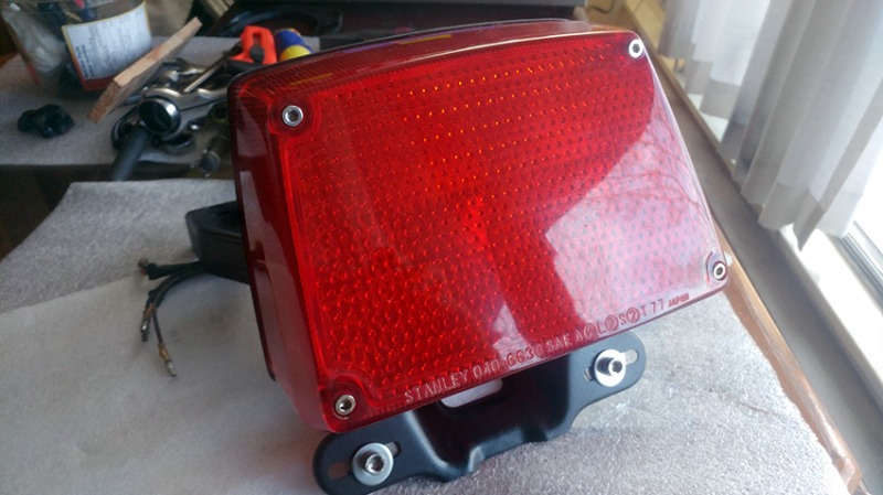

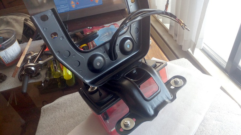

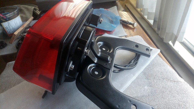

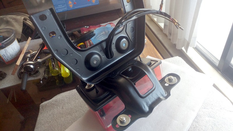

Another sub-component checked off the list. It took six (yes, 6) different parts sources and three major steps to complete it: bead blasting, painting, and polishing.
I am quite happy with the results
