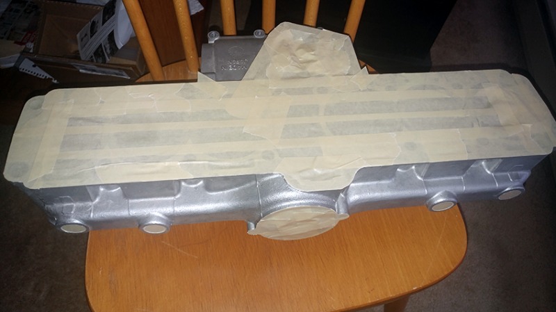

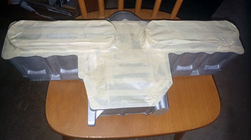

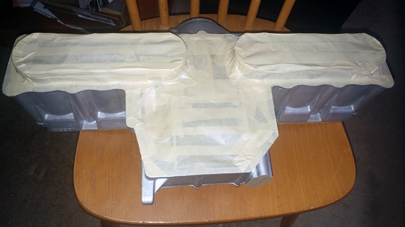

Another small step with the engine. Masked the cylinder block and ready for painting. Just waiting for the right conditions. I talked to the local machine shop and they use the same paint without the heat curing as stated on the can label. I will paint and place it against the heater to absorb all the BTU's. I've been told by the pros that these paints (VHT, by PlastiKote or other high temperature available brands), worked well in their pro applications. Lots of discussion about it, use primer on not, this brand or that, and I am going to go with my common sense suggests and I am sure the engine will not melt away! A few years down the road, if I don't like the look, it will give me another chance to take a closer look at 'the baby' and give it another make over. I just might like it in fluorescent green at that time!!

Going to look good when done, Stan. Hope you polished those "frost-plugs" :lol:

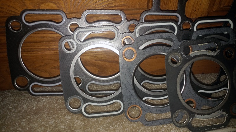

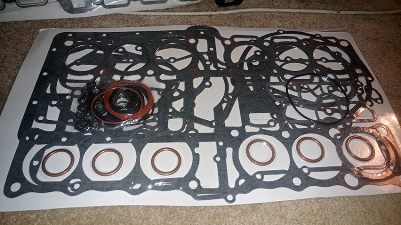

Adding to the memo fo my gasket searchings...

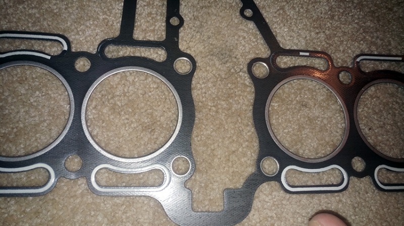

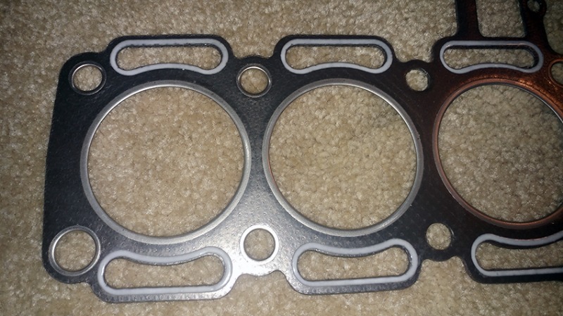

This is a comparison of four head gaskets I have. Top one taken off the bike. Surfaces look actually incredibly good. Except the missing, and no surprise, squashed seals around the coolant passages.

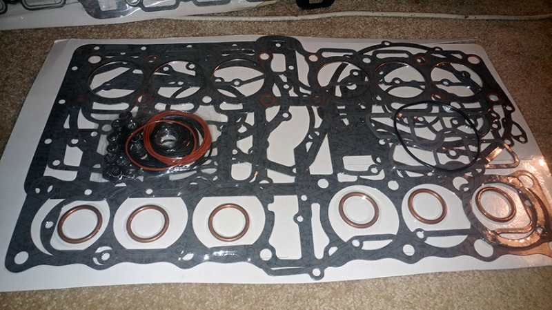

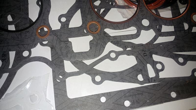

Next is the gasket which came with a full gasket set from eBay. No idea what it's made from, but the general sealing surface is exactly from the same material as all other gaskets in the set. It's overall not as rigid as Kawasaki and no surface stickiness present. Another thing is usage of copper instead of steel as in the OEM gaskets.

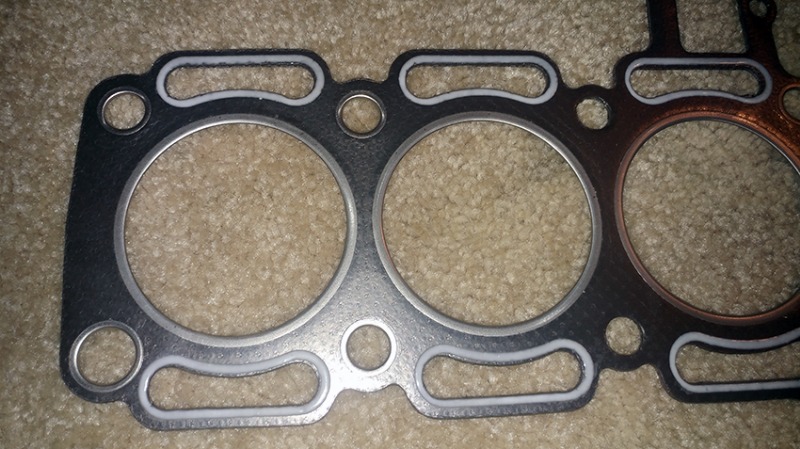

Third one - off eBay. Came damaged - the white sealing silicone (I assume) lines peeled off. Steel and copper used. Got refund for damage.
Last one - got it through Kawasaki dealership. All rigid and all water seals solid. The gasket has all steel and the surface of the gasket is tacky like if it has been coated with a film of silicone or some other adhesive. This is a second one I got and both are exactly the same and fresh. I had to recall the first one because it had a wrinkle from being bend. These are expensive gaskets at abut $165 Canadian dollars plus taxes, no need to take chances.
