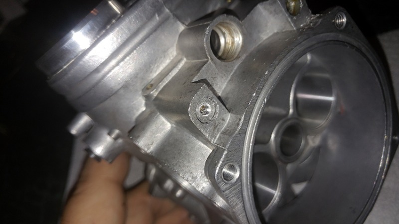

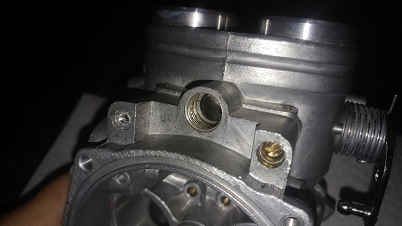

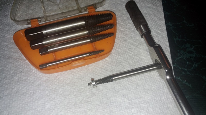

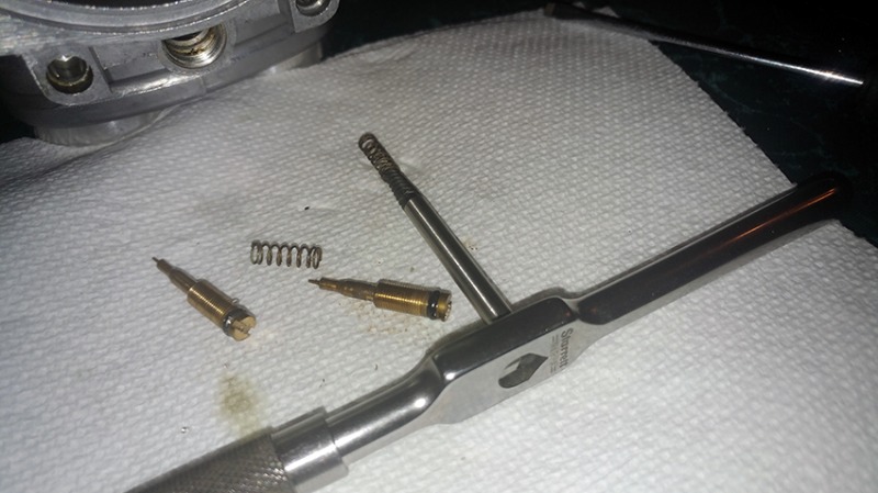

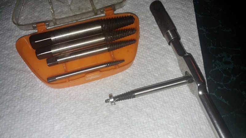

Last night I took care of the air/fuel mix screws and removed the plugs (thanks Scotch for the suggestion!)
After heating the carbs up a bit, I used a reverse thread extractor to remove the plugs. They came right out.
It was easy to pull the springs with it as well. Done

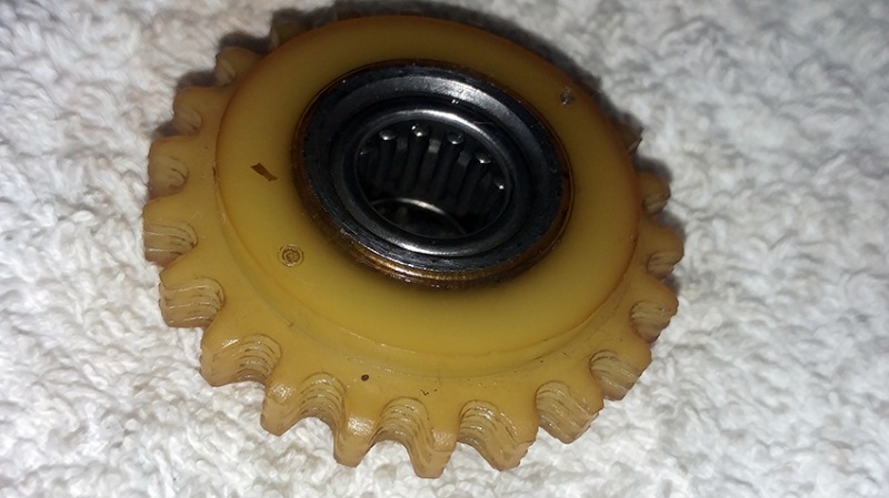

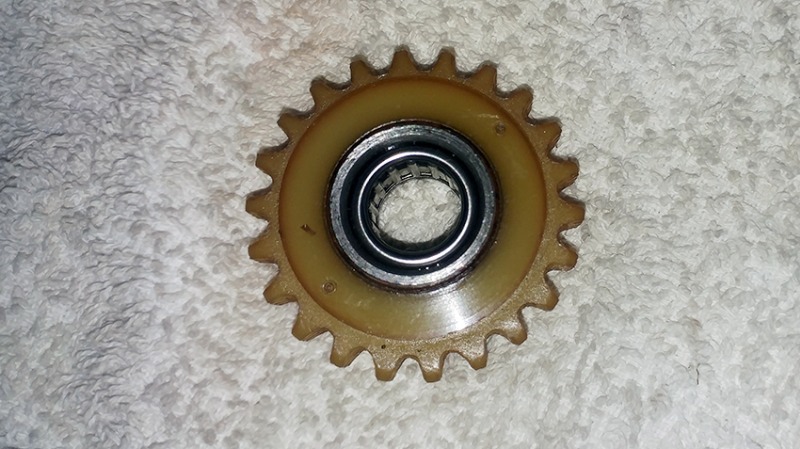

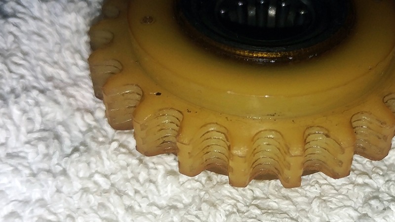

I was just going through the parts and came back to looking at the cam chain sprocket. I have never seen a new one so I don't have a point of reference.
How does it look in comparison to a new one?
8 years 10 months ago
I'd be tempted to replace it with one of these:
www.liskas.com/kz1300-cam-chain-idler/
Found this one, a bit more worn than your's
www.kz1300.com/index.php/forum/engines/1...-sprocket-is-a-wheel
Good discussion here re: metal vs plastic : kz1300.com/index.php/forum/engines/2314-...tensioner-gear#16389

Got this link:
but I don't like the idea of metal gear there....
Might be repeating but the kz1300.com is an obvious alternative. Already have it bookmarked.

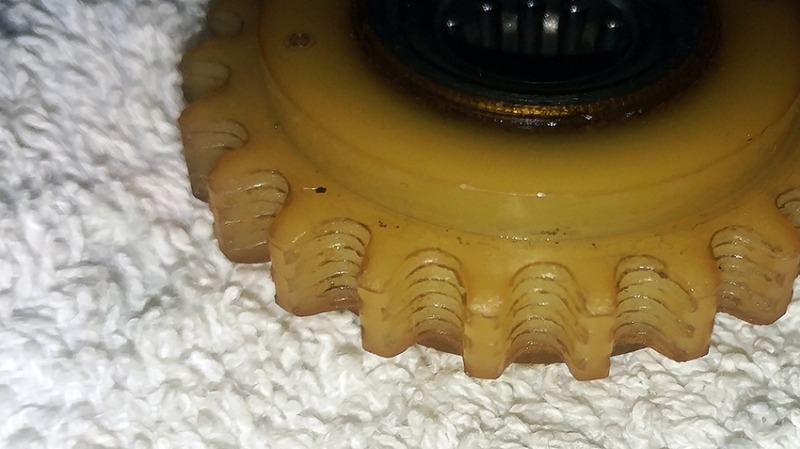

My gear looks like new by the outside shape, but are those grooves from chain links there on purpose or signs of wearing down?
