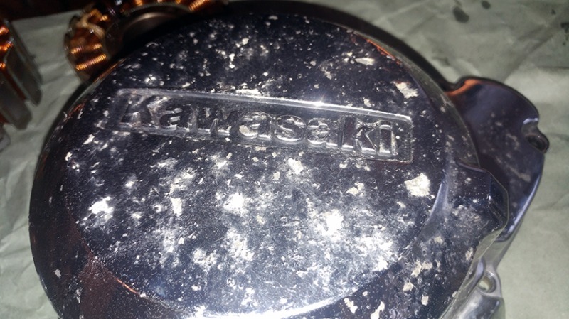

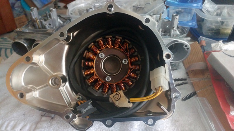

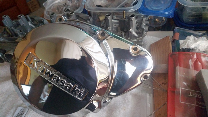

Picked up and assembled one of the covers.
This is how it came:
This is how it's now (the 3 bolts in the middle 69 inch/lb and blue non-permanent Loctite

Wow, that cover looks spectacular! Is it just polished, or has it been chrome plated as well?

Thanks! Yes, very pleased with the cover. Polishing wouldn't do any good, unless I'd use a grinder first to remove the old very damaged chrome and all the pitted discolored aluminum underneath. It is chrome plated. For anyone in and around Vancouver, BC - I recommend Dependable Plating. No complains so far, and no other place is affordable.
