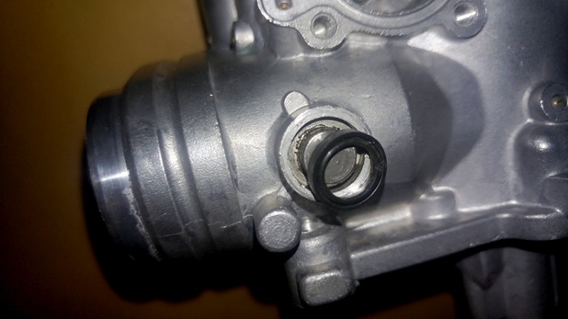

8 years 10 months ago
Besides o-rings, these throttle shaft seals seem to have a different shape. I haven't counted them, but there are maybe 6 needed if dissembling all, but just 3 when doing the dead ends on each curb. What are their dimensions? Did you mention them Kawboy?
