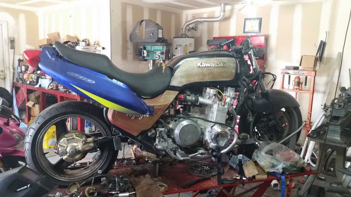

About two month ago I started this build on a 1983 ZN1300 after gaining inspiration from builds I've seen on this vary site.
Modifications:
ZX11 front end.
ZX11 rear rim.
Rear mono shock. (Beefed up R6 shock)
ninja 250 gauge cluster (temporary but it works!)
Custom tail (parts from a 02 Katana)
Things that need done:
Wiring harness needs some work.
Drill and tap the CCT for manual conversion.
Cut custom spacers with lathe for rear rim.
Fix lathe
Finish cleaning out gas tank with distilled white vinegar. (Works wonders)
Relocate battery and hope 205CCA is enough!
Full picture album: imgur.com/a/z8oTO
Modifications:
ZX11 front end.
ZX11 rear rim.
Fix lathe

Also I had a question I did not see in the FAQ, How do pod filters hurt the fuel injected bikes? The air box takes up a huge amount of space that can be used for other things. :whistle:
Bike mock up today:
Phil, I have seen your YouTube videos great job on the bike!
Bike mock up today:

I don't see how fitting pod filters will hurt the fuel injected bikes, although the DFI system won't compensate for it. You can always fit an adjustable fuel pressure regulator to compensate anyway
