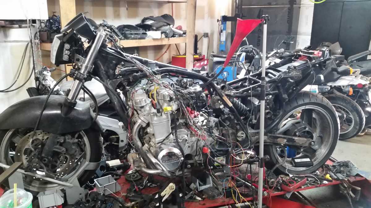

Update.
Got the bike to start and run for 30 seconds! Sorry was to excited for a video.
Built/building a custom wiring harness.
There will be three wiring harness's in the bike:
* Main Bike harness (Headlights, turn signals, switches)Wired but not wrapped/heat shrinked
* Ignition harness (Coil power wires, coil pickup, vacuum sensor)Finished!
* Charging system harness (Stator power wires, Mosfet Regulator wires)Not started
I will be upgrading the old Regulator/rectifier system to a Mosfet Regulator/rectifier system.
Taken just after it started and ran!
You can see the custom wiring harness in disarray. It is actually all wired up, I just need to wrap it up and solder the connections.

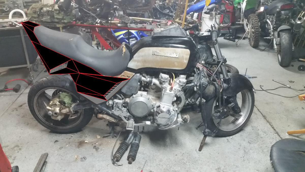

Been workings 7 Days a week the last couple months. Everyone wants their bikes worked on in the winter. Shop has been packed.
Heres an Idea for a custom tail.
