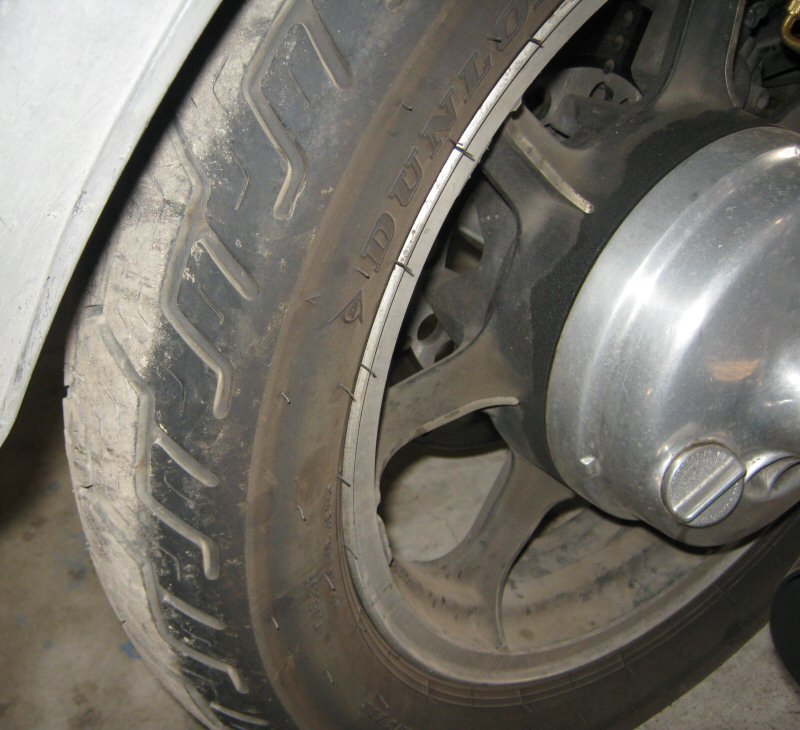

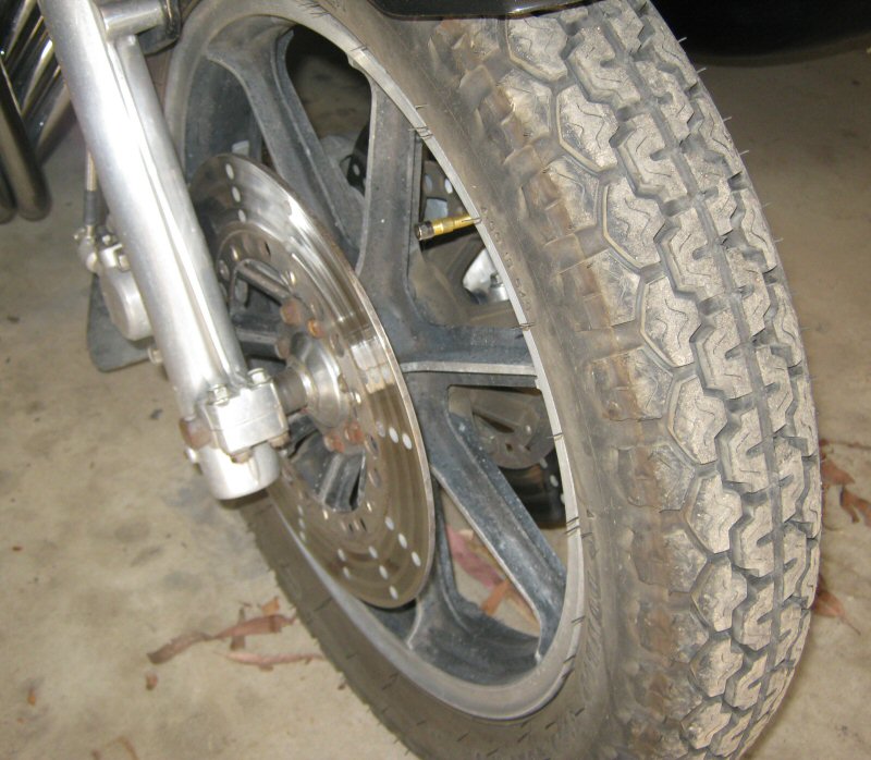

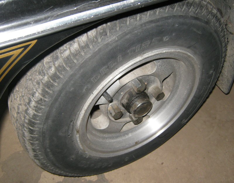

Many years ago on my first 13 with a chair, I put a vintage car tyre on the rear, it gave me about 4 inches of tread on the road, although back then the tyre was speed rated to 80kph, although I did do more than that and never had any problems with separation, I really haven't searched much for a good back tyre on this 13. At present i'm running a Dunlop K70 tyre on the front, it's a tube tyre on the tubeless rim, first ride had me worried as all the "nipples" of rubber on the new tyre rubbed under the front guard, made some noise, but they are worn off now and she is quiet, although the blocky tread is good for steering it does pick up a few pebbles on my dirt driveway. On the rear i'm running a Dunlop 404 Tubeless, good cheap tyre so it's easy enough to change when I wear the middle out, because I don't lean because of the chair. On the side car is a "Jelly Bean" mag wheel from a Mini, bloody new tyre cost me $90 !!!!!, but I only run about 20 PSI in it or she's too rough, just thought i'd let you know what I have, photos below, cheers Pete.

That's very interesting info Pete. So far in my searches I have only come up with an Avon Sidecar 3.50-19 Universal, which won't fit and a Heidenau K28, which may fit but I don't understand the sizing they use (4.00 – 18 M/C 70P TT?). I hadn't come across the Dunlop K70 in my searches and just looked at it now, half the price of the K28 but they are quite different tyres. I forgot to mention Metzler has a Block K sidecar tyre as well for around the same price as the K28.
Presently I am running a Dunlop Arrowmax GT501 (for rear wheel use) on the front and a Bridgestone Spitfire 11R on the rear.
What size is your sidecar wheel, 12 inch?
Thanks for sharing Pete
