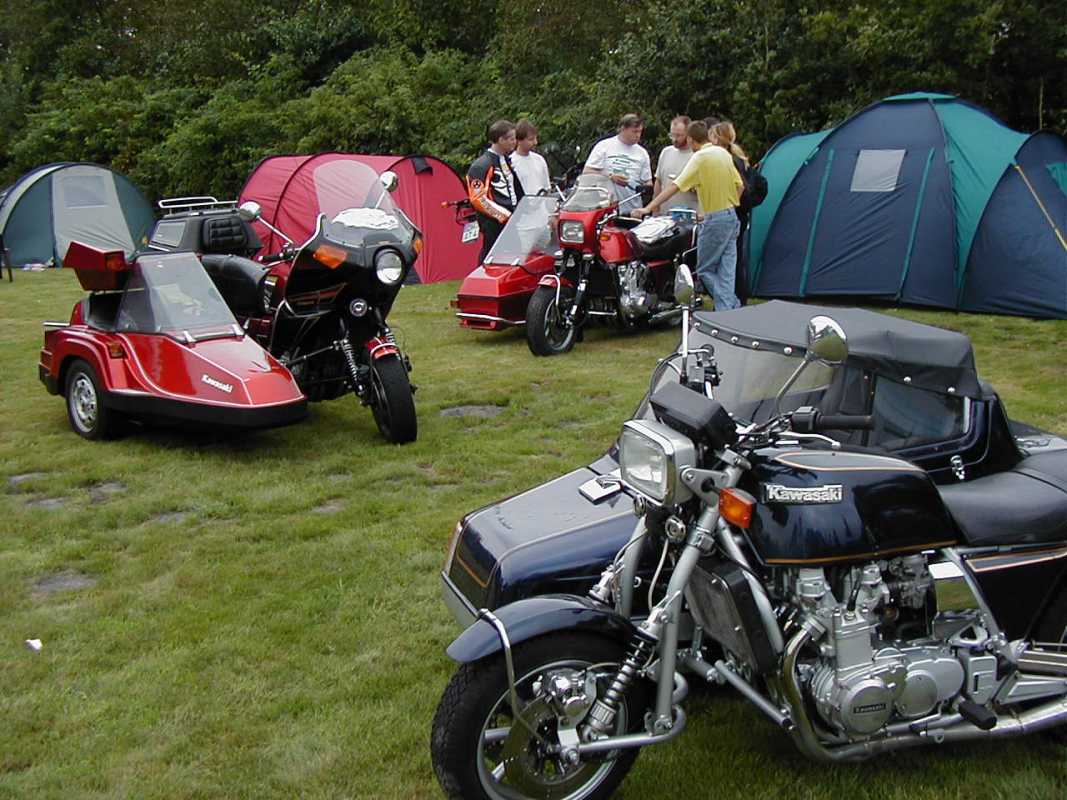

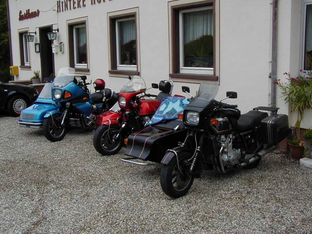

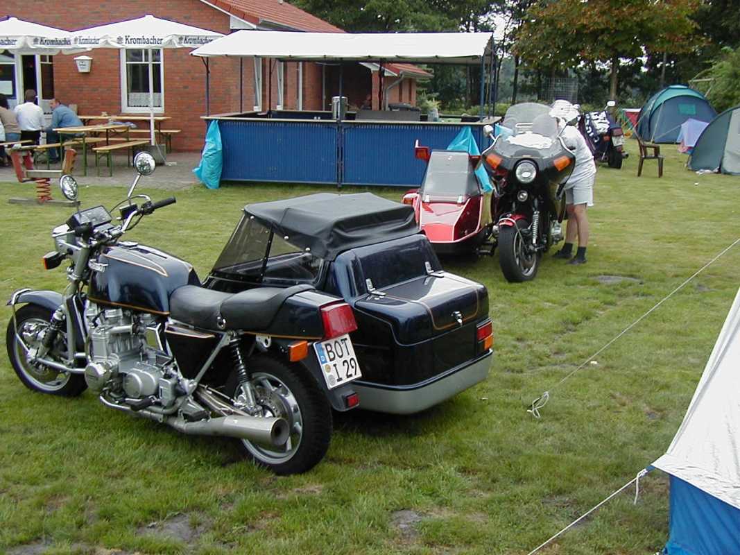

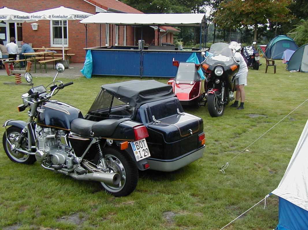

Dunno if it helps to determine the right thing:
regulation in Germany (you know, the are very strict about regulations) allow car wheels on the sidecars which then may be equipped with the corresponding tyres. Of course not every wheel, but some that are suitable. Needs to be verified by an engineer (of course not by any, but the right ones according to the regulations).
That's why the sidecar guys are able to use the "cheaper" car-tyres whereas the two-wheelers still need to buy the expensive ones. In some occasions the regulations (here they are, again) will allow only certain types or even brands !
The US is much more liberal in that- you are the lucky guys.
