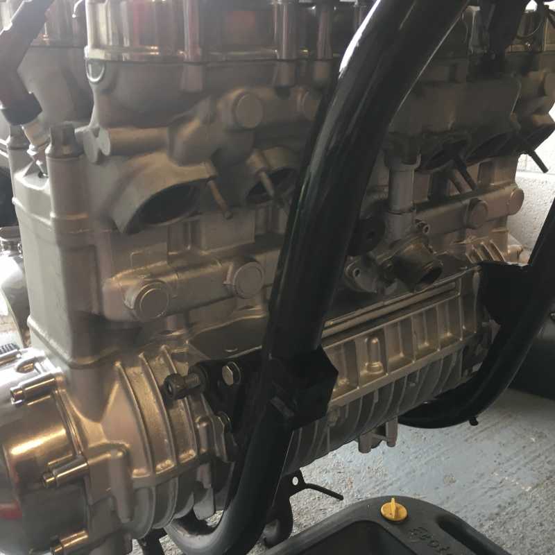

B) Time to get rid of that disgusting original petrol blue colour. This is the first coat of Clostermann 2k F40 primer, flatted about 20 minutes after spraying. Horridly toxic and vile smelling I used a mask and ventilation, the way it goes on though is deeply satisfying. 72 hrs required before I can spray the 6000 m lime green base coat.

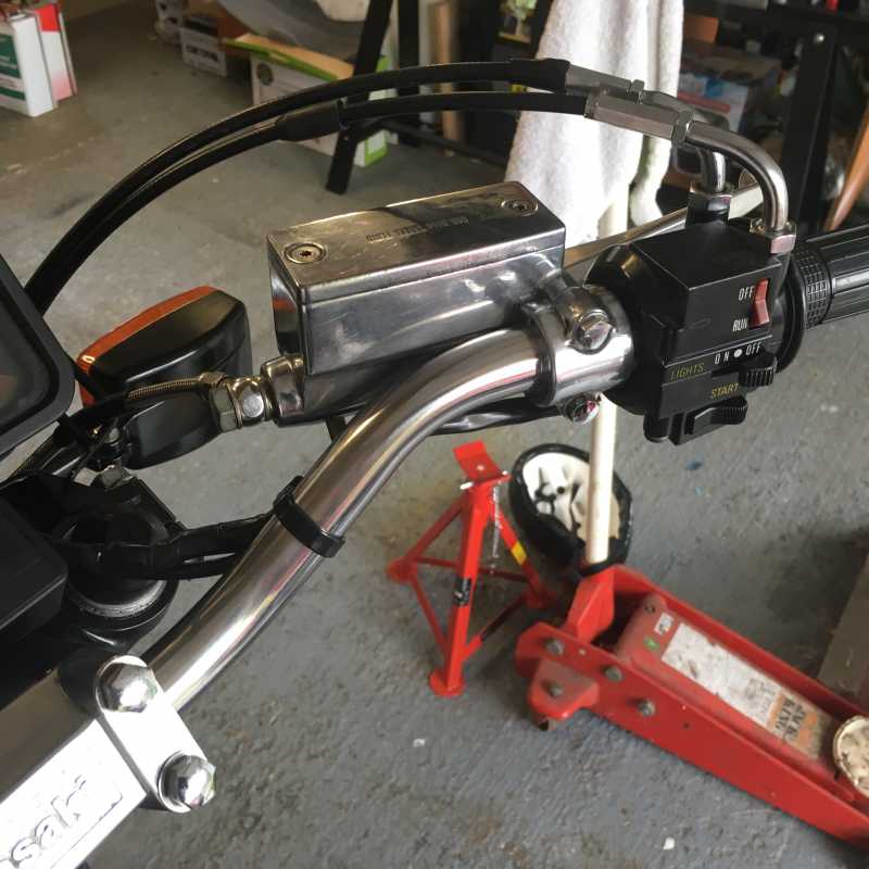

Master cylinder polished and all switch gear stripped, cleaned and rebuilt. The engine face and hangers painted in VHT.
  • Tonto
  • Tonto's Avatar
  • Posts: 468
  • Thanks: 127
Re: Hello fellow Z1300 enthusiasts
10 years 4 weeks ago
#14590
Looking good !
What colour have you decided to go with on the paint set ?

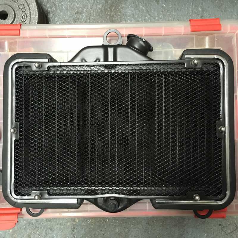

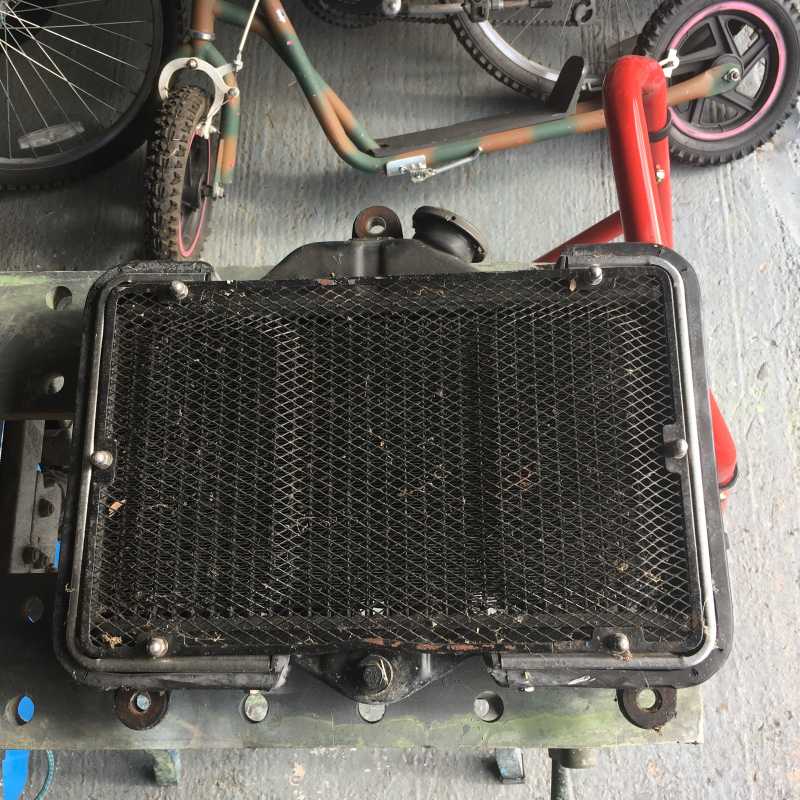

B) Just finished the radiator and I think it has come out alright. I spent hours rubbing it right back to the metal and then sprayed it with Rustoleum high temp satin black. The inside of the rad is in really good shape so I have left it as is. Here is the before and after.
  • Ledkz1300
  • Ledkz1300's Avatar
  • Posts: 627
  • Thanks: 71
10 years 2 weeks ago
#14684
Rad looks great!
