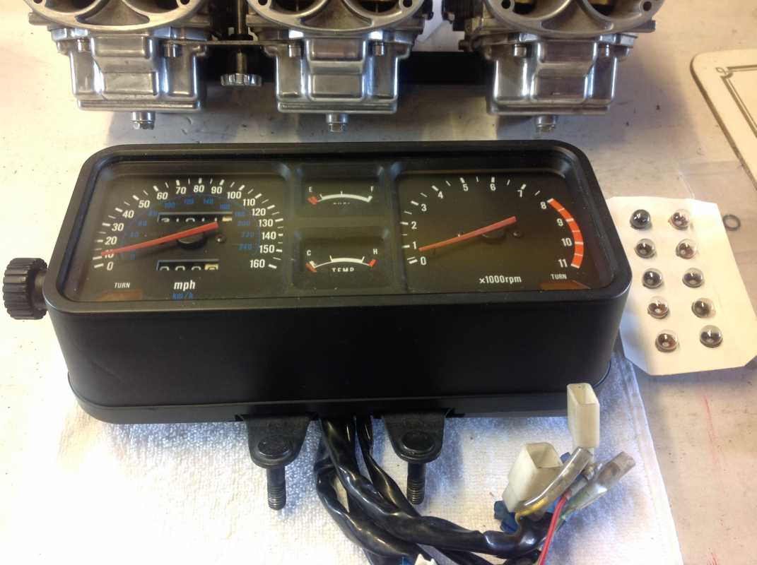

Re: Hello fellow Z1300 enthusiasts
10 years 4 months ago
#13122

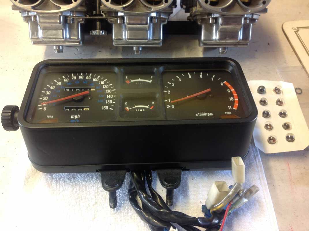

That's the speedo case finally finished. I couldn't get the original small round 4 W bulbs so I fitted the closest I could get. What I am not sure about is the length of the glass envelope- they are slightly longer than original and I am hoping that it does not put the hot bit too close to the coloured lens of the warning lights.

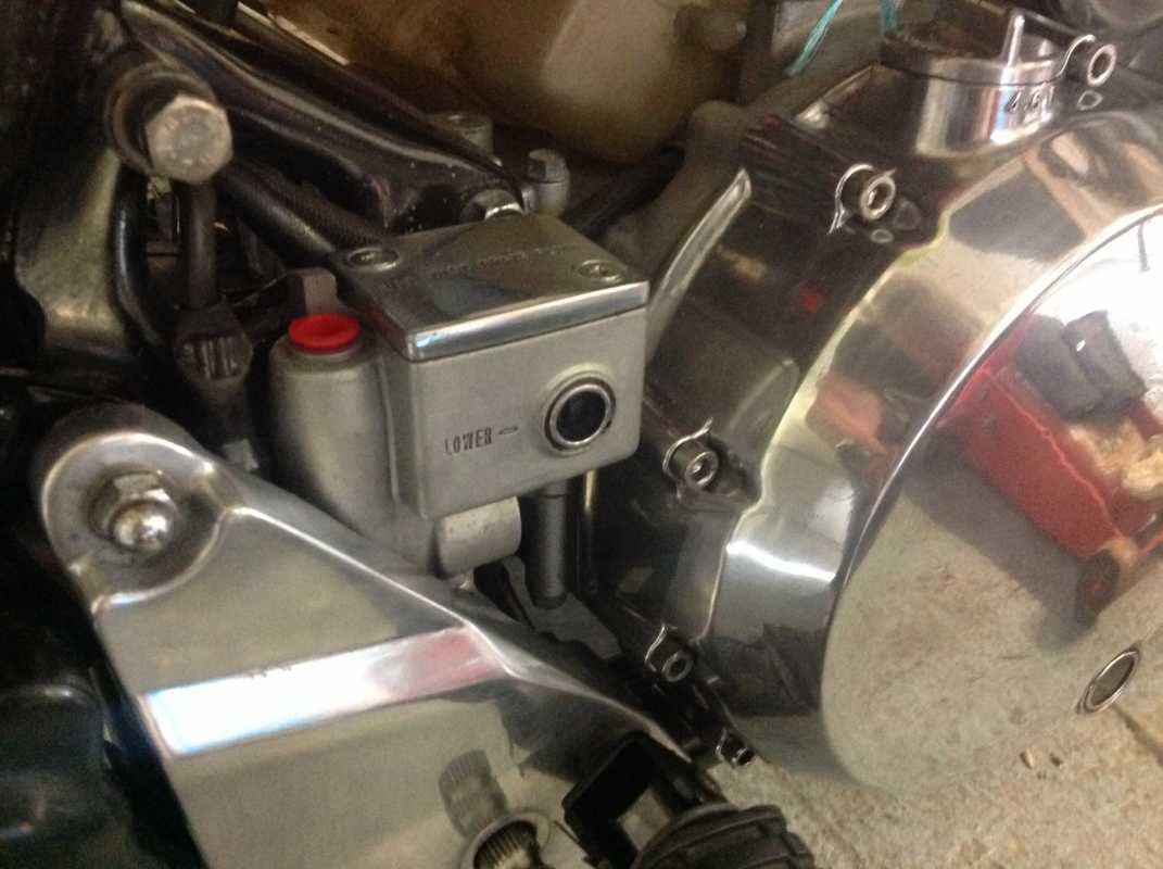

#13197
My rear master cylinder was weeping and , trying to find replacement parts and seals proved impossible so, I sent it off to Past Parts and they were able to bore it out, put a srainless steel insert in and fit it with a modern seal kit. All done at a bery reasonable £122. I dread to think what an original would have cost- if you could find one . I ran the master cylinder cap and bolts, the peg hanger and the peg through the polishing wheel and I think it has tidied up that area nicely. I am still debating whether to use the original brake hose, which seems ok, or to put one of those coloured , modern ones on it. B)
10 years 3 months ago
#13199
Looking good; excellent advice re master cylinder as well :cheer: .
I have black Goodridge hoses on mine.....looks a lot better than standard IMHO.

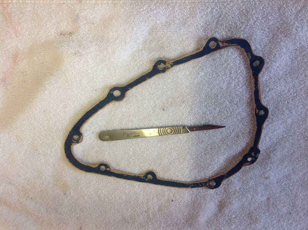

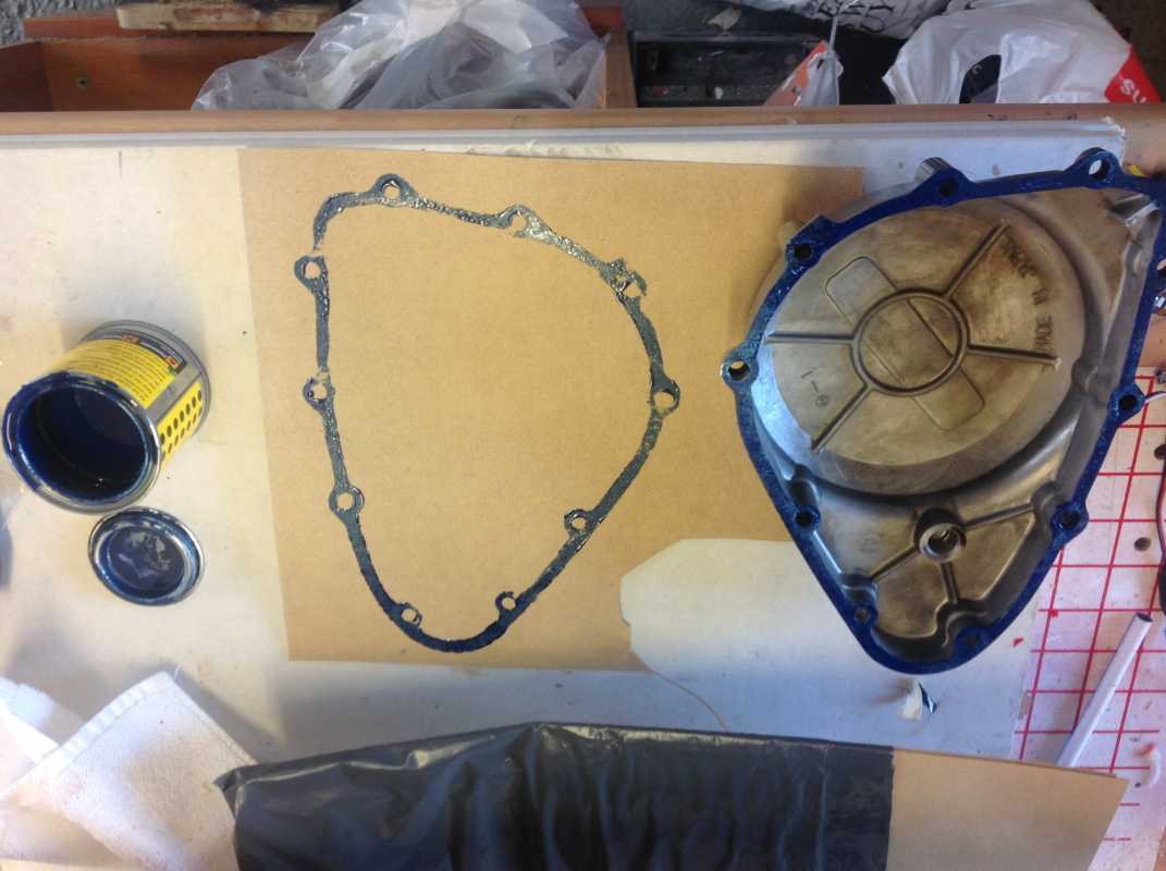

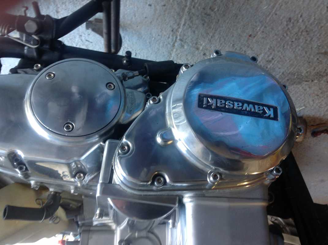

I couldn't get a gasket for a couple of the covers so had to do it the old school way and make my own. The gasket sheet came at very low cost from Ebay. I ran the cover through the polishing wheel and fitted new stainless bolts. It is the same story with the transmission cover.

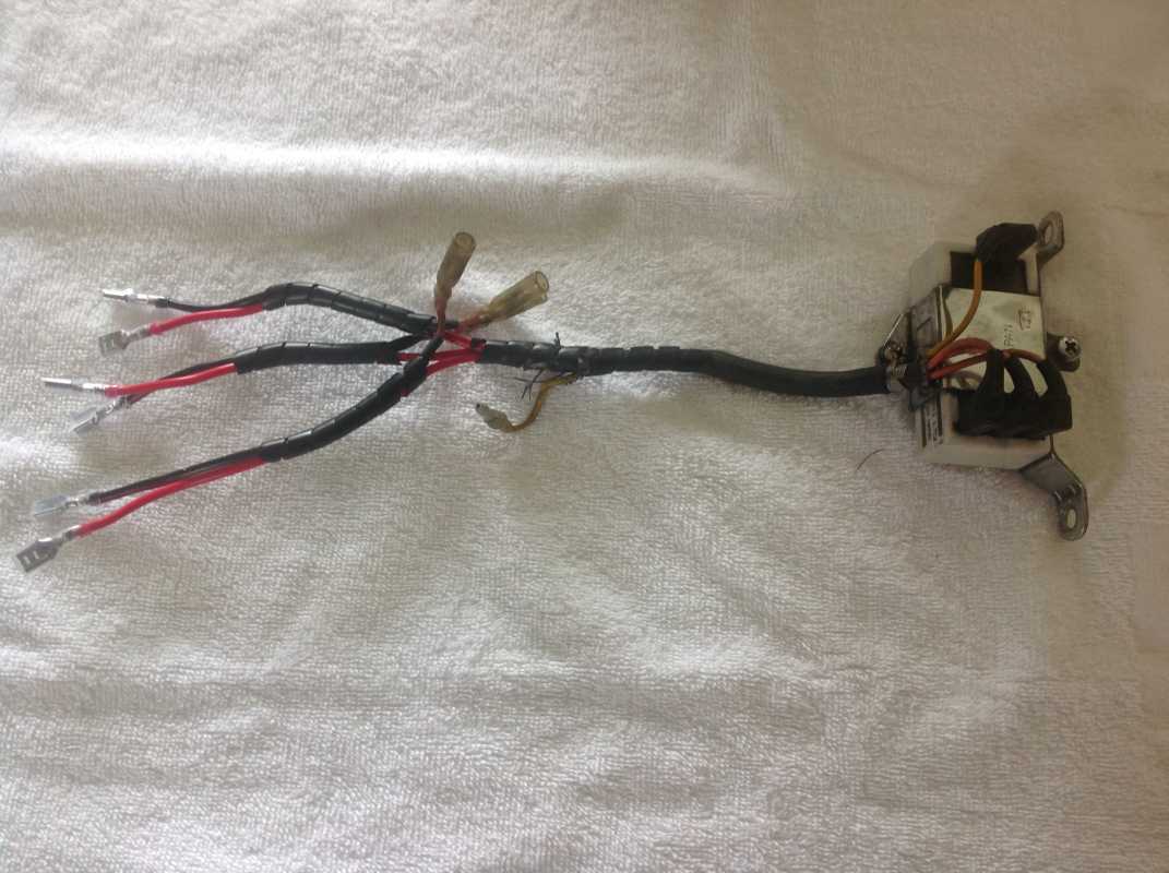

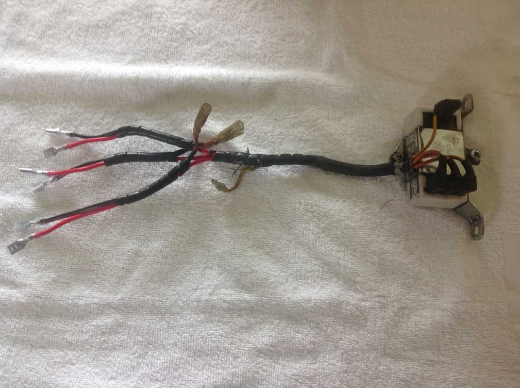

10 years 2 months ago
#13971

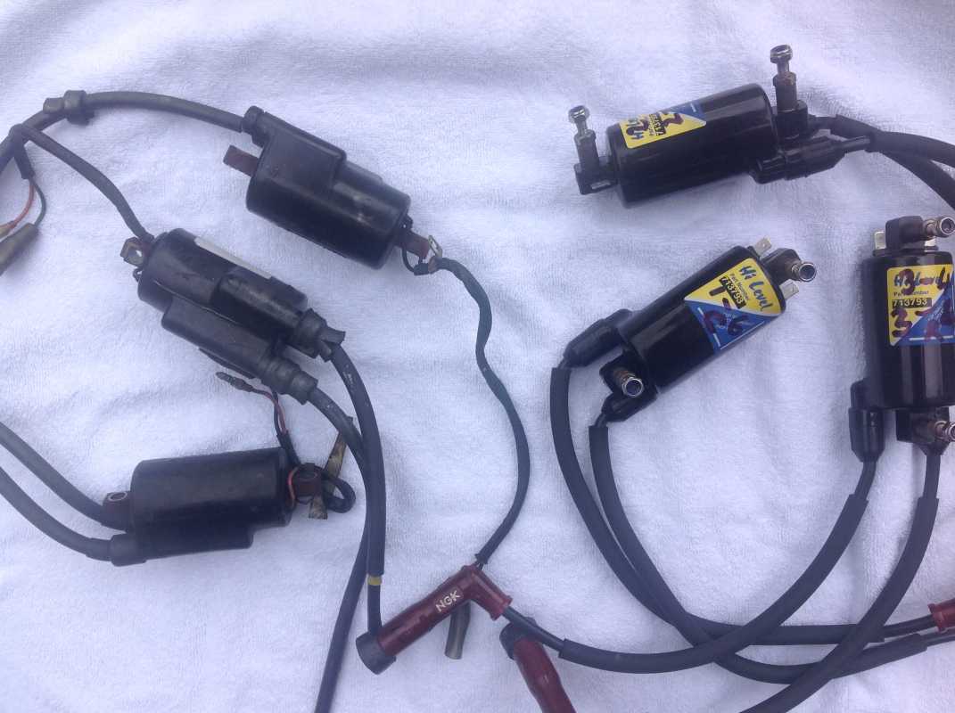

:( next up the ignition system-oh dear! All three coils have got cracks in them which, at best, is not good. I got onto good old Ebay and sourced these new coils for £85 quid for all three. Trouble is the new coils have different connectors to the originals so I had to make up a simple conversion to match them to the ballast resistor that feeds them with the required electrical input.

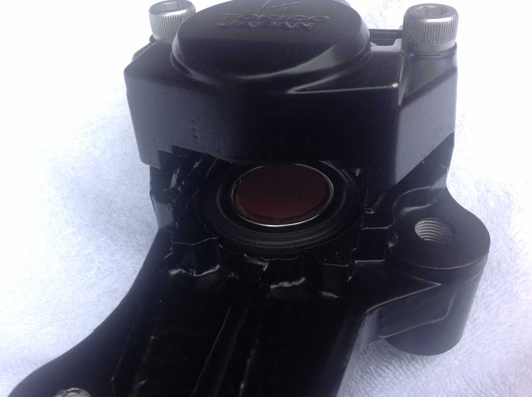

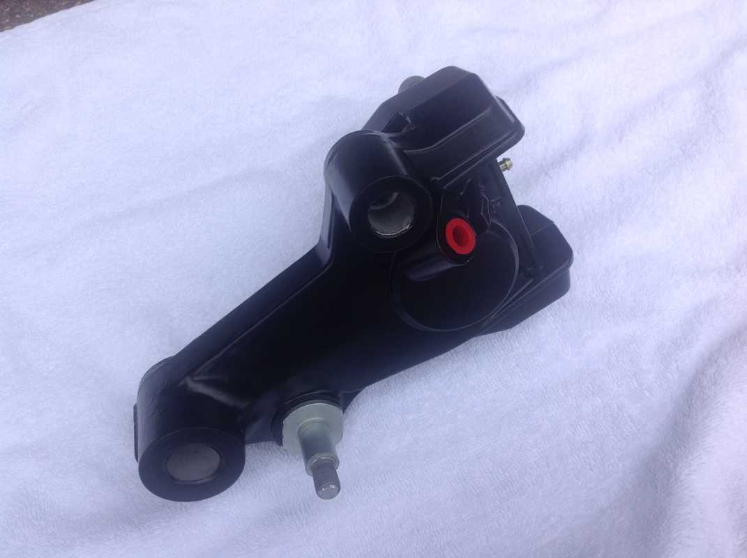

#13973

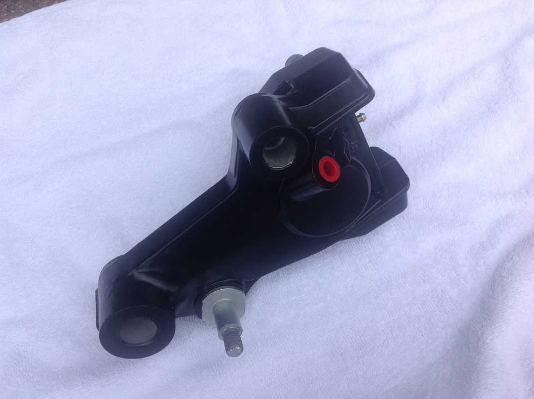

B) My newly rebuilt rear caliper again from Past parts. This is an absolutely first class piece of rebuilding at a very reasonable cost. This caliper looks better than new and sports a modern set of seals into the bargain- well pleased.
