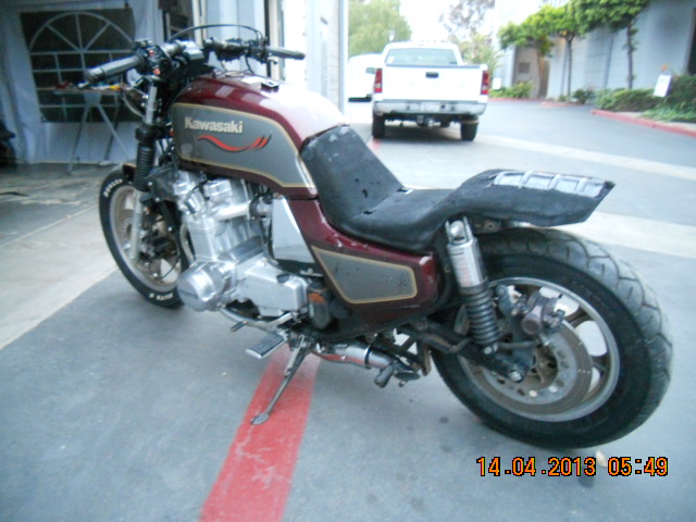

A number of us have done what you suggested. The frames are quite different than the KZs or Zs of the same vintage.
Here's a pic of my as still unfinished project bike.
http://www.kz1300.com/index.php/member-s-galleries/image?view=image&format=raw&type=img&id=113
It's my intention to remove the fairing once I'm satisfied with the fuel injection setup.
Regards
PS. The radiator is mounted where the left side saddle bag used to be.
Regards

10 years 5 months agoTake another look at my Voyager above.benspilk09 wrote: ...I haven't seen anyone with a 6-1 exhaust on a voyager either, is there a reason for this? The DG system would be a must have for me
