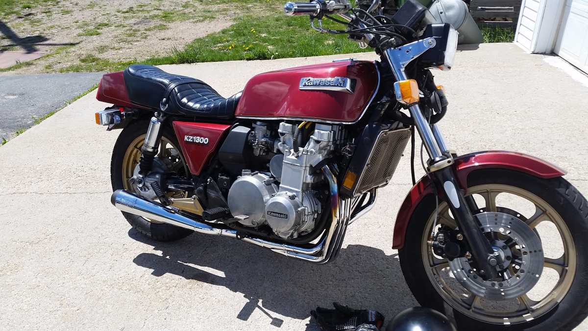

I'm in the process of rebuilding a 79 kz1300. So far its taken 2.5 bikes to make one. One engine was worn out and bottom end parts are hard to find and quite expensive. The 81 bottom end was incompatible with the 79 top end so I ended up sourcing a low mileage engine. So far I've spent well over $7000. I had some bad luck and I'm not much of a mechanic... plus I made some mistakes along the way. I'll probably make some more before its over.
You've come to the right place for help and advice. I would have given up a long time ago if it weren't for some of the people here. Don't be afraid to ask lots of questions. I certainly have.
Here is mine so far. Lots more to do but I'm getting some riding in and loving it.
