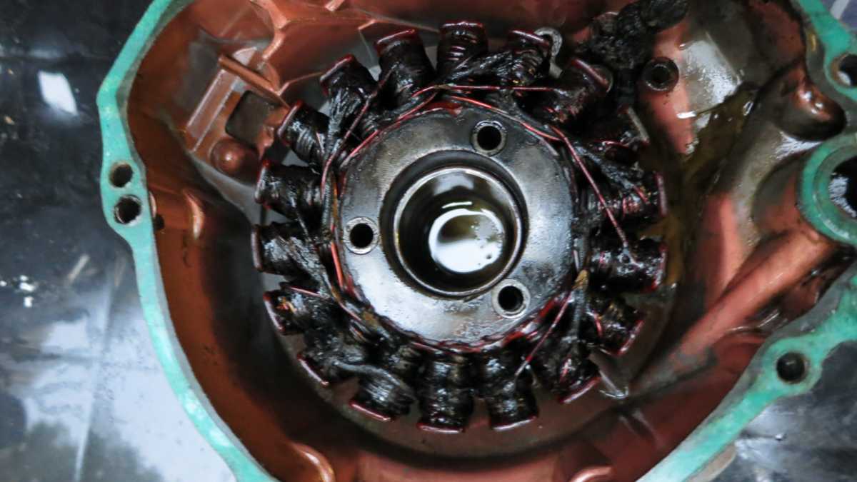

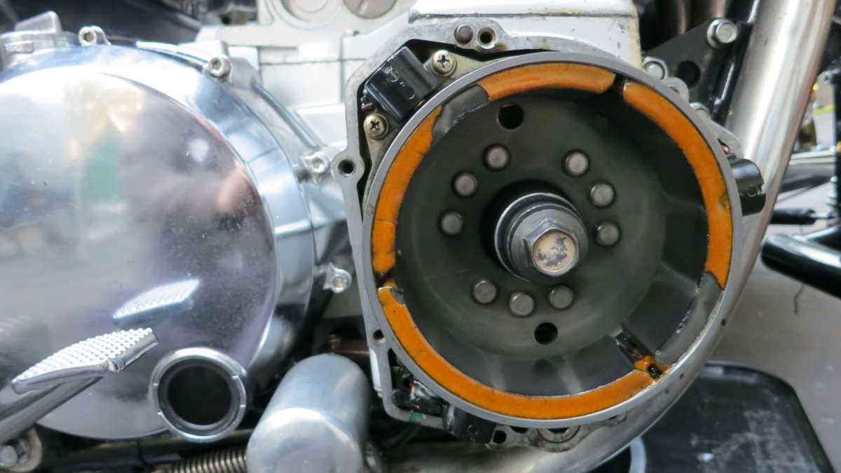

I would like to get opinions about the state of the alternator rotor and stator. I'm figuring the stator is cactus but I' not sure about the rotor as it has the coating on the outer edge coming off (see photo), will the condition of the rotor effect the proper working of the alternator?

Forgot to ask, what's the best way to remove the stator? I have removed the 2 screws of the wiring harness and also the 3 screws on the stator, I just don't want to force anything and the stator seems to be in there pretty darn good.

Gidday from a bit further north. Looks like that stator has been deep fried and is most likely full of short circuits and earths. You can get them rewound, I had one done aboout 2001 but unfortunately he is no longer in business and is retired like you and me. They are notorius for burning out. It should just lift off there so maybe the molton goo has made it stick.

With those bolts removed it should just lift straight off. It may just be a little tight on the aluminium guide in the center.
The electrex stators are very good

Thanks RickG. I have ordered the Electrex Stator and Res/Rec from Wemoto. I just want to make sure now that the condition of the rotor isn't going to refry the new stator.

Thanks zed_thirteen. I ordered the Electrex stator from wemoto today. Should get it in about 10 days or so.
