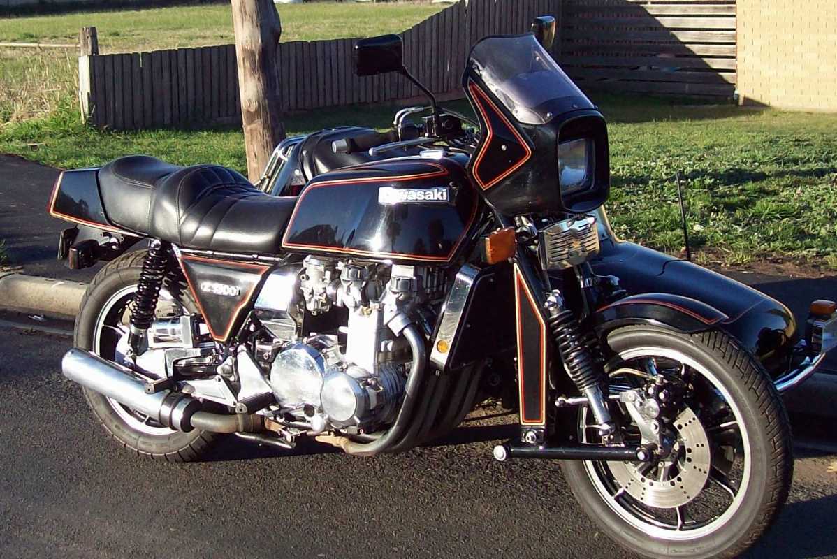

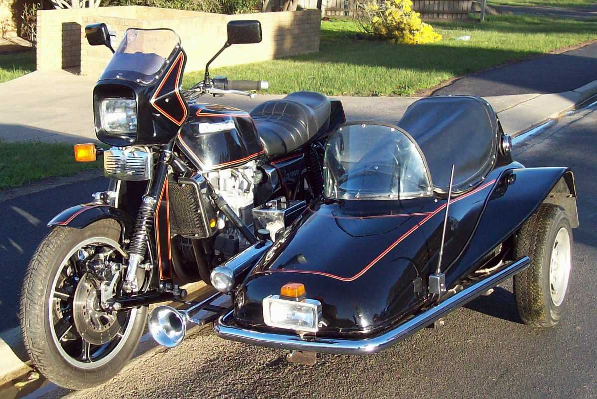

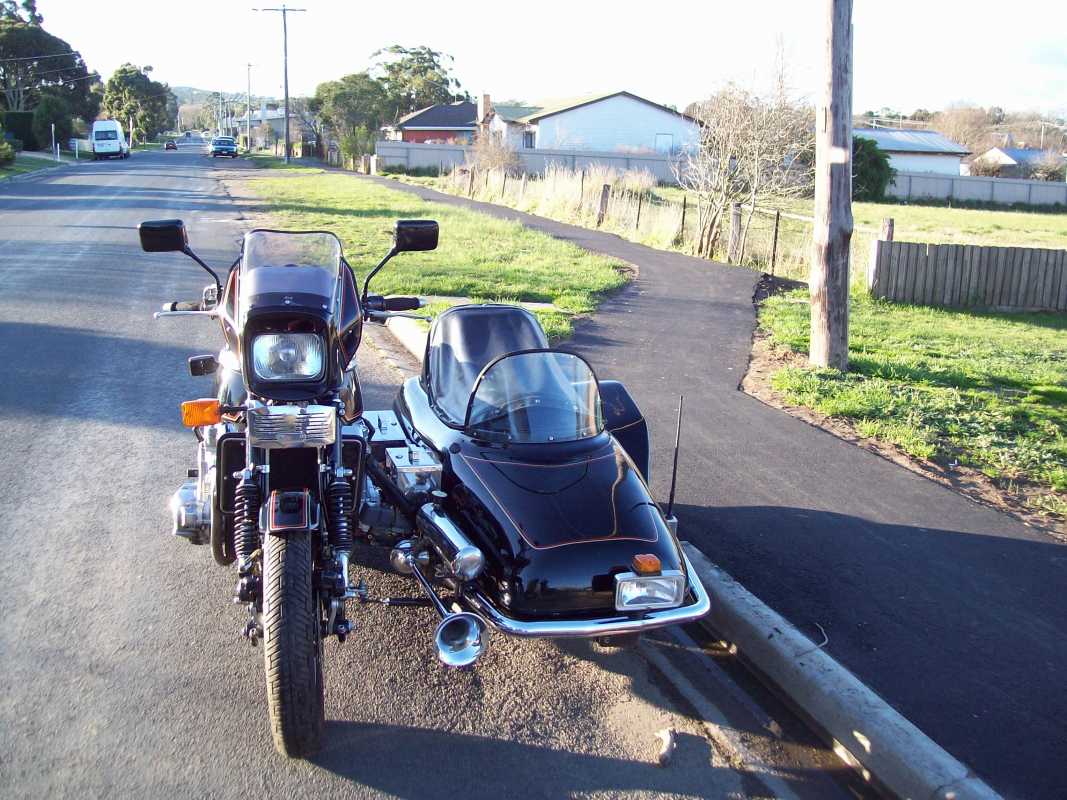

Love that horn!!! But doesn't it come in a set of 3 trumpets?? Could really use those up here to "wake up the dead" who like to cross the line while texting on their cellphones!!!
Actually, if I could I'd put a horn on the KZ off of a locomotive. then they'd have my attention. :woohoo: :evil:
- Posts: 594
Re: Hi from Australia
11 years 2 months ago
Damn a leading link !!!!!!!!! was going to get one on my rig, but decided not to so I can take off the chair and ride a "normal" bike if I wanted to, what brand is that front tyre ??, I am using a Dunlop D404F at present, it didn't last that long, but rear D404 is lasting very well, was going to try a Kenda on the front and see how that goes, I did find a vintage car tyre many years ago that fit the rear rim, gave me 4 inches of rubber contact on the road but was only speed rated to 80 kph (but held up to faster speeds), made it a bit harder to pick up the chair
, still looking around for a car tyre for the rear, the 17 inch rim makes it hard, cheers Pete
