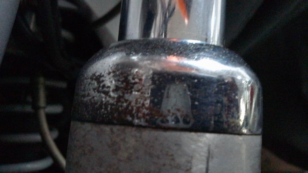

2 years 5 months ago - 2 years 5 months agoWe have a problem with the use of chrome.I should point out that I have nothing against Delkevic, parse. I simply had a "boner" for the Chrome look as opposed to that of S/S, that in my mind was more in keeping with the "theme" (?) of the bike.I'll comment on the "Eastwood" when there's been some significant mileage (and heat) put on the pipes. I can report however that the exposed base layer of nickel on that
In Europe, the manufacture of chrome parts is PROHIBITED from 2024 without providing any solution.

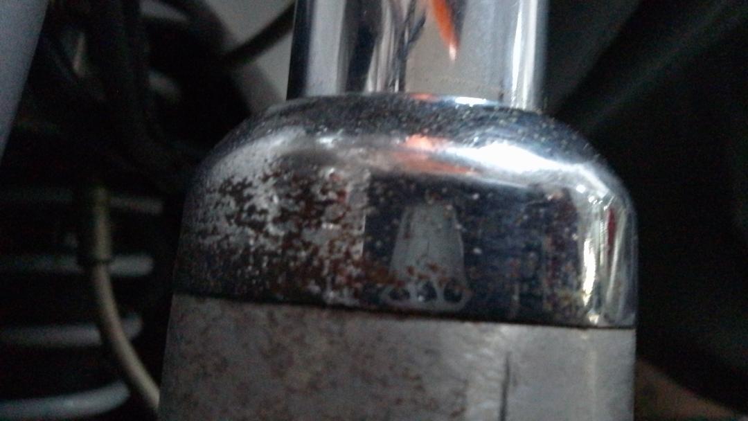

I'll give you a couple of examples, I have a BMW R1200 Cruiser, full of chrome parts, my motorcycle was manufactured in 2004, this model began to be manufactured in 1998, in 2000 the environmental regulations on the manufacture of chrome parts, well, the first series until early 2001 retain their perfect chrome, not my bike, they are all pitted and deteriorated due to a different chemical treatment, I have to remember that my bike sleeps in the garage, never on the street.
This is what the fork bars look like, judge for yourself.
I have Spanish-made motorcycles from the '60s and '70s, some have been in a shed for years, my Kawas are also more than 40 years old and none of them have the chrome plating in as bad a condition as my BMW, before the work was done so that They will last a lifetime and part of another.

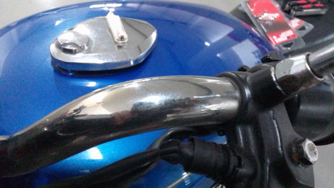

Another example, when I repaired my Z650 I changed the handlebars, I had suffered an accident and I didn't like the one I had mounted.
I bought one of Italian design and brand, it was not cheap at all.
Well, filling the brake master cylinder, I poured a little brake fluid on the handlebar, I cleaned it with a paper cloth, as I had always done other times that had happened to me. After a few days I realized that I had lost the chrome in the stained area.
The clutch side is still spotless, perfect.
I think that the solution to the problem of the ban on chrome plating, without having to travel to countries like India to manufacture new parts, would be to manufacture components in polished stainless steel, but I don't know if the costs would be viable or if all the parts can be replaced by that stainless steel material.

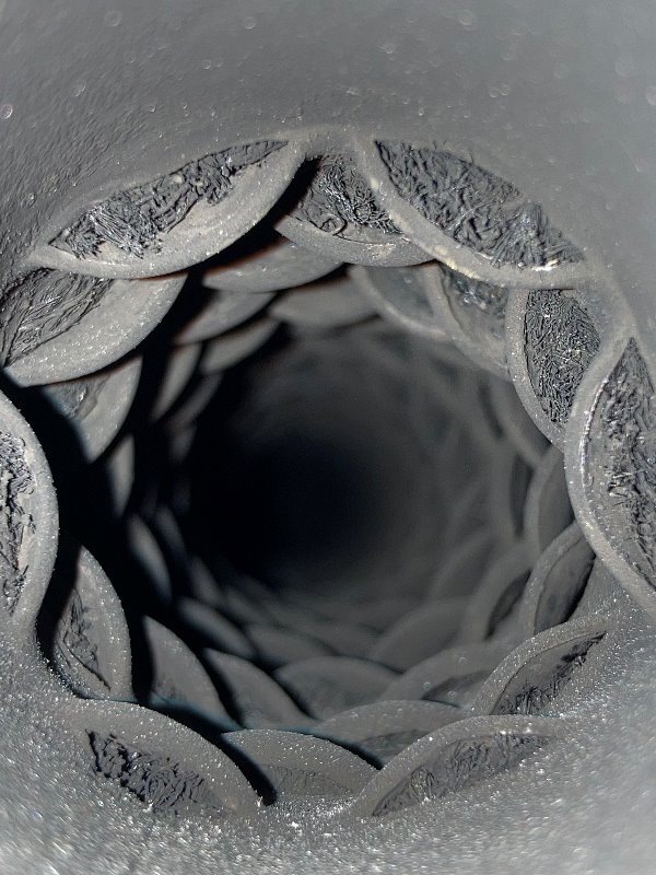

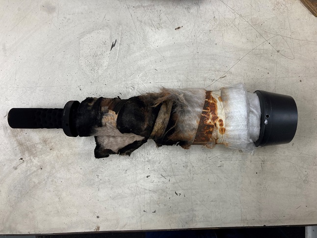

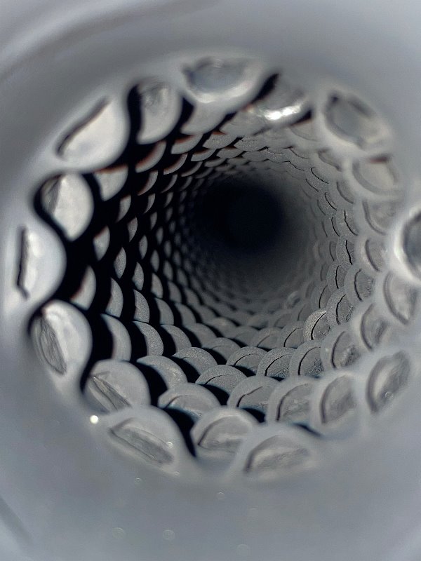

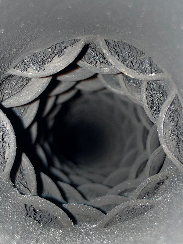

The nonsense continues !! For most of the '23 season I had been striving for "mileage" and could repeatedly achieve 58mpg. This season, starting with a new D.G., I was obviously interested in what these numbers would be. Same route, same 274 kilometers and a maintained 100kph. 50mpg has been the best I can achieve. A discussion with someone more learned in these things resulted in the conclusion that the new muffler had too much back pressure. The baffle was removed easily and this is what came out.
The baffle-tube has a completely different arrangement of "Vents". Much smaller and more numerous then my 33 yr. old D.G muffler. You can come to your own conclusions regarding this detail AND the "carefully" wrapped fibre-glass dampening.
After all these years I have finally discovered what D.G. stands for .........."D.umb(G.)asses".
New
Old
The Mouse nest ! Carefully and strategically wrapped, and secured with............"masking tape" !
"Let the games begin".
New
Old
