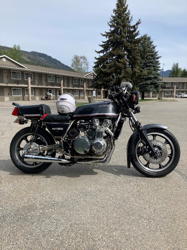

After 3 years of procrastination I finally broke down and bought a new D.G. header, to replace my original 33yr old one. Should go without saying, I was "fairly" excited as I removed all the gleaming Chrome from the box. First thing I did was treat the inside of the 6 pipes with "Eastwood Internal Ceramic Coating". (Another topic)This coating dries FAST, so was soon starting to install the pipes. This is where the shit started and never stopped ! None of the header pipes would fit into the cylinder-head. The flanges diameter were too large ! Now at this point some would have sent the whole system back to D.G.I on the other hand decided I could reduce the flange diameter with a Dremel and stone.....so I did and got them all to fit. I'll estimate the flange diameter was reduced approx. .025" to .030". Problem solved. A note here: With 33 yrs. of previous experience re & re'ing my original D.G. numerous times I found an easier way of installing the system. With all six pipes in the head and the collar nuts "snugged", I grouped the 6 pipes together as they would be in the Collector. I slid the Collector/Muffler assembly thru the center-stand and got down on the floor to insert the pipes. Another W.T. F. moment when I discovered the pipes were different lengths ! ? All 6 pipes should insert into the Collector a measured 1.375". The varying lengths meant that the longest ones would seat before the shortest, leaving the shortest inserted by a mere 1/2". Again: Most would have sent the entire system back to D. G. however the solution was simple enough so after buying an appropriate size tubing cutter I trimmed the longest 3 pipes to match the remaining 3 which were the same length. Another issue solved ! With the pipes back on, now loose at the collars, I started to install them into the Collector. A trick I use to aid in this is to suspend the muffler at it's approximate height with a bungee cord. This gives lots of movement at the Collector-end to make the pipe insertion significantly easier. I got 3 pipes installed and everything came to a halt. I could not get a 4th pipe installed and realized that there was virtually no movement from the suspended muffler. The muffler was jammed against the differential. There was nothing I could do to resolve this. I then took my old collector/muffler and slid it thru the center-stand and - guess what ? It fit perfectly ! I put the both muffler assemblies on the bench and the issue was a no-brainer. The NEW assembly was assembled and welded out of the correct orientation. As if no jig had been used !I sent an email with photos and got a quick response.

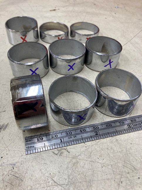

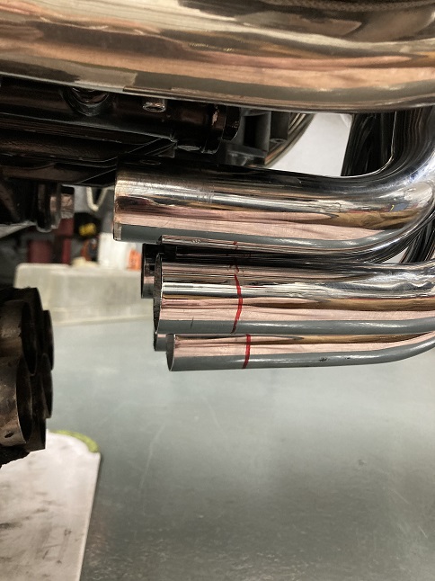

D.G. and I came to a resolution. After 3 months of fucking nonsense, I have the "Chrome Exhaust" I wanted. I managed to get the muffler/collector to fit without and re-bending required. Only after I trimmed the pipes another 3" in order to get the muffler supports to line up and have the "exit bend" align with my modified center-stand. I called the only "plater" in my area (They nickel plated my frame 41 years ago) and asked what the turn around time would be. "7 to 8 weeks" FUCK ME...will this shit ever end ? So: I am currently using the #6 pipe and will have it re chromed next winter !If you're considering a Header it looks like the only option now is a S/S Delkevic !

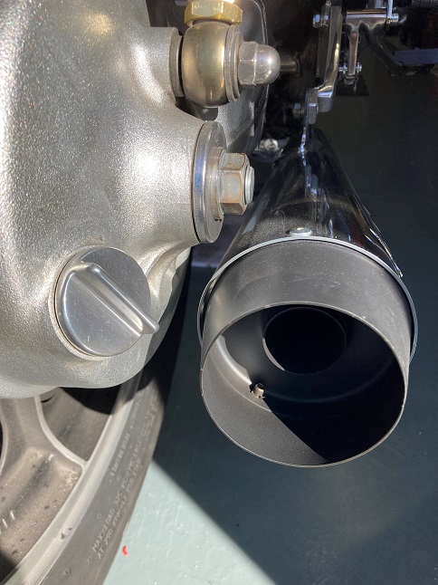

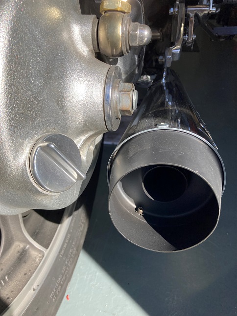

If you decide to go with a Delkevic, I have a couple of options to suggest.
I love my Delkevic system, but I wanted a different look for the muffler. I ended up using a short resonator (Cherry Bomb style) polished stainless muffler (built-in 90 degree turn down outlet) with a wide polished SS band clamp to connect to the mid-pipe. Not too loud--the rush of wind over my helmet drowns it out at cruise, but a nice bark under acceleration. I can provide a picture and further details if you're interested.
That left me with a brand new megaphone-style muffler with its included three baffle options and all the associated mounting hardware. I only ever test fitted the muffler, and it's never had exhaust through it. If you were to buy this, it would give you two options: 1) see if Delkevic would sell you just the primary pipes and collector/mid-pipe and use my muffler, 2) buy a complete straight muffler system AND buy my megaphone for comparison.
And of course if Delkevic would sell you just the primaries and the mid-pipe you could choose your own muffler like I did.

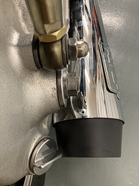

This story is absolutely criminal. All DG Performance makes is exhaust systems and I can appreciate that they had a change to their chroming process because of California environmental changes. Timing in this case got Scotch caught in the middle and that's unfortunate. The criminal part is the lack of communication and leaving the customer hanging while they tried to figure out what to do. They should have picked up the phone and talked to Scotch and told him they were in the middle of changing their chrome plating service and that there were issues to work out and a time delay would be involved. Then they should have offered Scotch some options to resolve his issue. rather than 10 weeks of bullshit emailing.

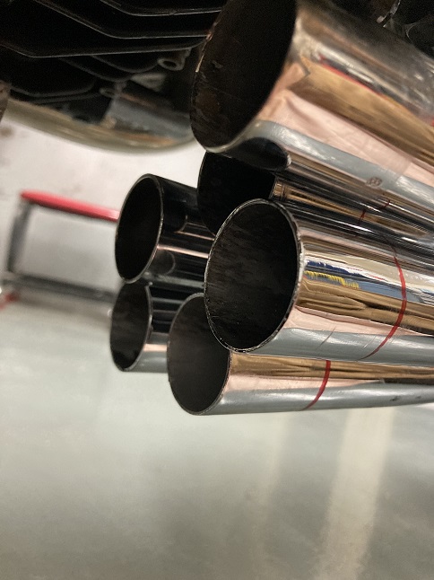

There was also a number of issues with the manufacturing of the pipes. Every pipe was too long, a weld on the muffler was wrong, all of the pipe flanges were too big in diameter and to top it off, one pipe had been damaged and an attempted repair to the pipe removed the chrome from the pipe. WTF !!. DG should have insisted on a full return just to figure out what happened there. If it was one pipe that was a problem, deal with the single problem, but in this case, every pipe was wrong. Somebody really screwed up here and if your only product is exhaust systems, then you better get your shit together or you will lose your business.

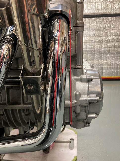

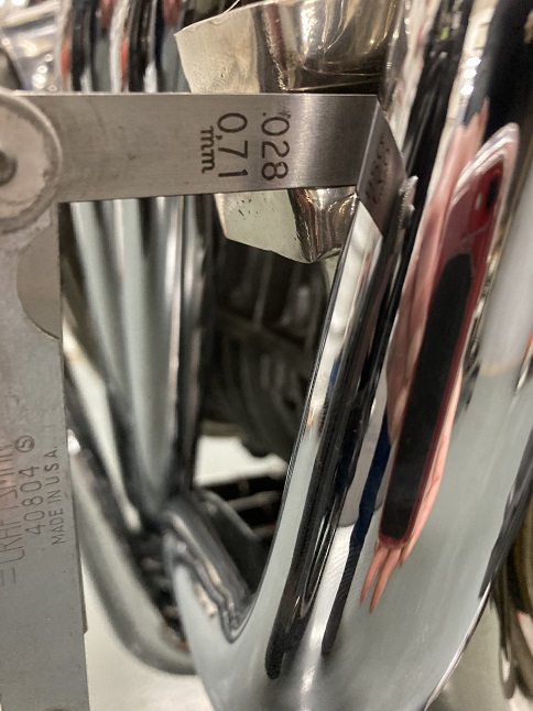

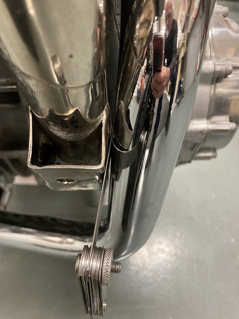

I'd be remiss if I didn't also add this "Tid-bit". Initially, with the 3 pipes installed (partially) and jamming the muffler up against the differential I also discovered this:
Digitally measured @ 5 degrees off vertical !
Initially, the pipe was hard against the Radiator mount. I was able to "drift-over" the mount to achieve the "whopping" .024" clearance.
I did end-up with about 1/4" clearance. This was a result of both the final shortening of the pipes and reducing the pipe-flange diameters. The original flange diameter reduction (minimal) was done per pipe and only enough to get them to fit into the cylinder head. The final reduction was done by reducing the diameter to match the O/S dia. of the split-collars. And No.....there are no exhaust leaks ! This resulted ( somewhat mysteriously) in achieving the final position of the muffler and adequate clearance of the pipe to frame gap. The irony here is that my original D.G. had the same "off vertical" angle and 1/4" clearance to the frame, on the #1 and #6 pipes.
In the end (no pun intended) I was able to get adequate (?) clearance. If not for having the former D.G. I'd be none-the-wiser. And honestly, I prefer the closer fit to that of the previous.
