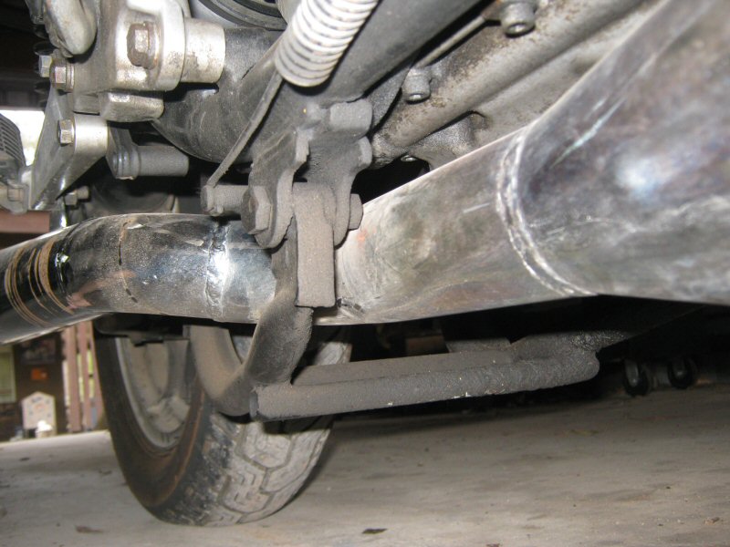

I havent see the pipes but by the photos they look like they are one piece so when installing the muffler needs to feed through the centre stand?
Is that correct? Or does the stand need to be removed to install?

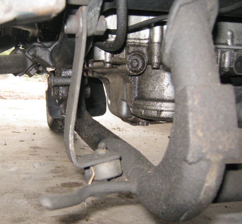

It feeds thru, see photo of mine including the stand stopper extension bar that usually comes with them, the center stand ends up being about level, still heaps of road clearance, although I don't worry about it with mine as I have a sidecar
