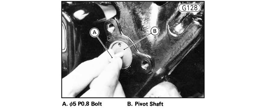

The "service manual" pg 160 shows pulling the pins out using a 5mm bolt with your fingers. Picture is worth a thousand words.
That being said, most people have had to use a slide hammer with a 5 mm threaded bolt to pull the pins. Some have even had to drill and tap the pivot pins to 8 mm to get a heavier thread to pull the pins but the bottom line is the pins should be a clearance fit in both the bearing race and the frame journal otherwise you couldn't pull the pins out with your fingers as per pic.

I think Kawboy he already had that done, and now trying to install new bearings and re-install the shafts (aka. pins)
