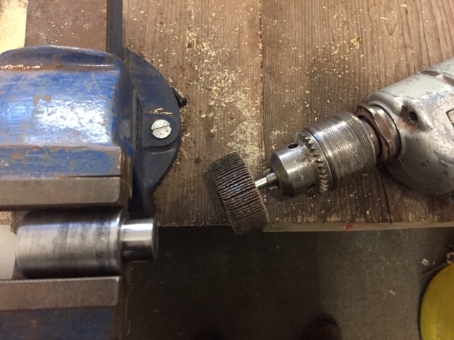

Please see the tool I used. A little sander wheel on the drill. Then I simply went all around the small diameter of the pin until the bearing slid on snugly.
Then, brainwave.... I did the same with the bigger diameter of the pin, cleaned it all off and took a little bit off the pin all round, and presto.... the pins now slide in with a gentle push.
So I inserted the bearings and caps into the swing arm and inserted the swing arm into the frame, then pushed the pins in and did the final adjustment as per the manual. Done!

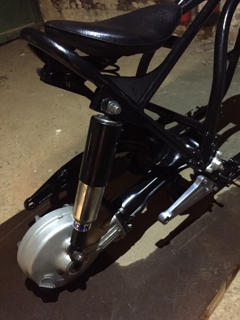

Great! And a great moment in your build when you are putting parts on the fresh frame
Those shocks, I know you mentioned it before, maybe, what are they and how much did they cost? I might have to source these if I can't find a stock replacement.

They are Hagon shocks, specially made for me. Slightly shorter than stock as on my bike with the altered frame they attach a little more forward, and they have been set up for my weight - single rider only. £210 all in. Bargain.
