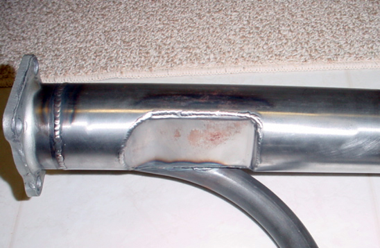

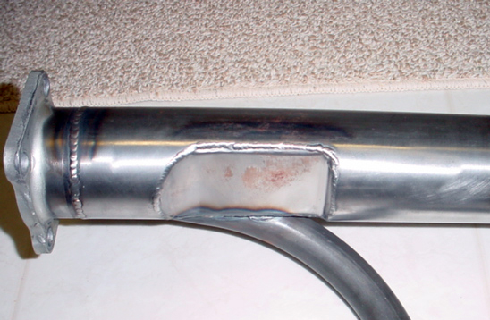

The first thing is relatively simple - a notched swing arm. It can only go so far, as issues with needing to move a wide tire towards center will happen, so further fabrication might end up with having an offset and needing to move the brake caliper and using spacers. And you still end up with some offset, which is fine if not to much (1/4 - 1/2 inch) - you wouldn't know the difference and it wouldn't affect riding (speaking from experience).
This 'borrowed' photo is not KZ1300 but another bike. Behind the scenes it's all similar.
Other things are bracing the swing arm for added stability (visible in the photo), extending it (might require extending the drive shaft), installing an aftermarket wheel of different size which might require shimming.
With stock or notched swing arm, to change a tire might require installing it with no air in it and removing the final drive.
