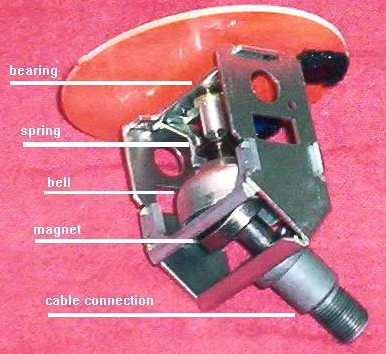

Found a good picture of the inside of a tach. Not kz1300 but so closely resembling ours it could have been made by the same instrument manufacturer.
Picture was unceromoniously ripped-off and posted here without written of verbal permission from "Scca28" on "motorcylceforum.com". Thank you !

Thanks Scotch
will I be okay to clean the top of the magnet face or is it coated in anything, forgive my ignorance but I have had and run z1300s for nearly 30 years and have always changed the tacho cable in 5 minutes flat without any issues , im not sure if its my old age or the bikes but its frustrating to say the least
all thanks to everyone for your help its much appreciated
