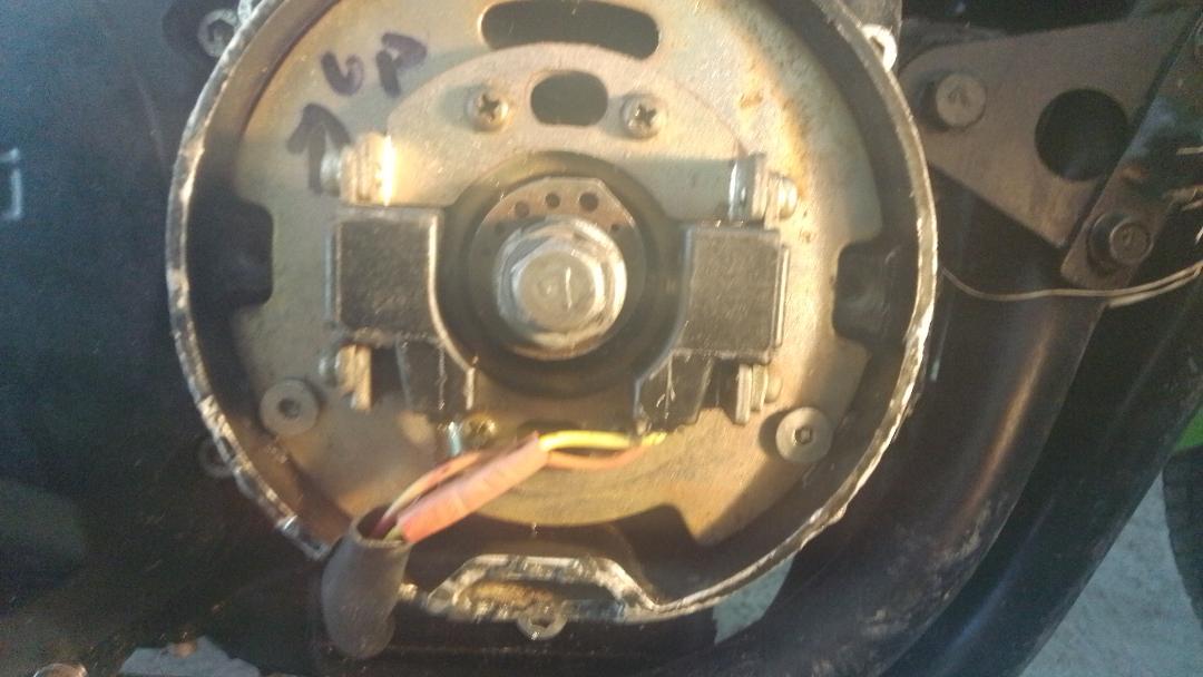

Looking for either a complete good pick up assembly or one good pick up coil. for my 1980 project.
Thanks, Don

Pretty sure it was the same pick up coils (except just two of them) for the 4 cylinder models of the same era
 My '82 GPZ1100 uses the same ones, one with the red and yellow wires and one with the blue and black wires.
There is a third one that has green wires for the Z1300.
Of all the places I looked Z1300.de has the best prices and proven quality components.

It does look like the kz 1000 pickups are the same. I found a 1300 assembly on ebay. It's on the way, hopefully it's good. I'm betting the bad pickup coil for 3 & 4 was why the previous owner gave up on it, changing coils and what not. We'll see.
Thanks, Don
