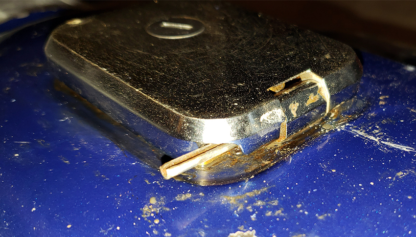

Screwdrivers, hammers, chisels, drills, and a drill used to open this gas cap..... In case of the gas cap, you can remove it by tapping the pin out. Then it comes off and is ready for any servicing - which I am doing right now on a cap that came with a rusty tank. First - the cap was stuck completely solid. It took quite a bit of time and shaking a mix of nails and vinegar to 'unstuck' it. The rust crust came off and applying Kroil (the best in my opinion penetrating oil), all started to wiggle and move around nicely. It wouldn't open with a new made key (from a helmet lock from the same bike so it should fit), so I removed it tapping out this pin. The latch was still stuck. After a quick ultrasonic cleaning all moving freely. Now further dismantled, more manual and ultrasonic cleaning, and it should work. If not, in case like of a stuck the broken off key tip, a cleaned up gas cap should be an easy thing for a locksmith. If not - at least no guilt after trying all other solution before destroying it.
