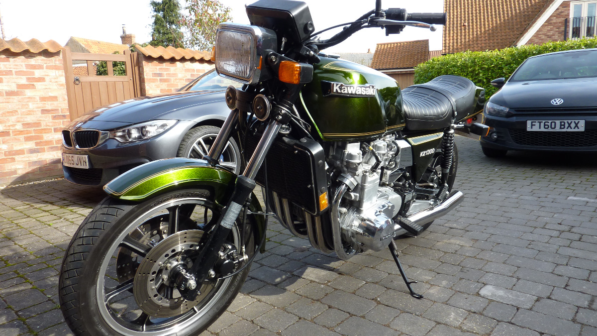

Does anyone have one of the small round rubber covers which cover the pozi screw heads on the Radiator Side Covers on a KZ or Z1300 (both the same part).
This just fits into the black rubber strip that is fitted to the chrome rad surround.

Pete not sure if these are "No Longer Available" - when I got my Z13 they were missing and I could not locate any replacements, so I tried fitting a headlamp drain bung rubber of my Z900 - it fitted almost perfectly.
I subsequently bought 6 from Z-Power: they are a tad more raised than the originals - but way better looking than a screw head
( see pic)
Cheers Tim
( see pic)

Great tip thanks.
They look very acceptable on yours mate.
Thanks again
