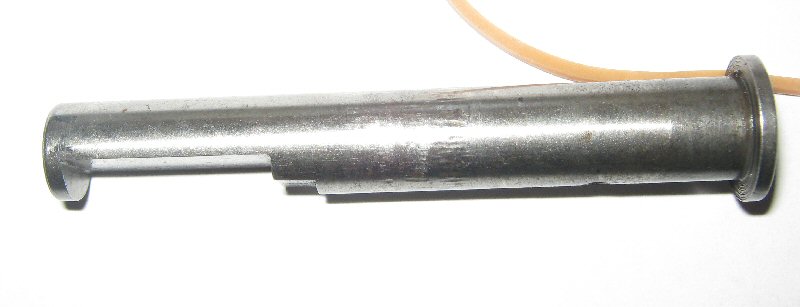

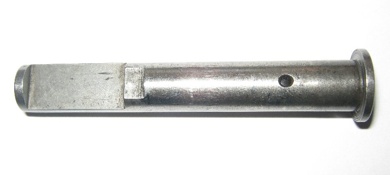

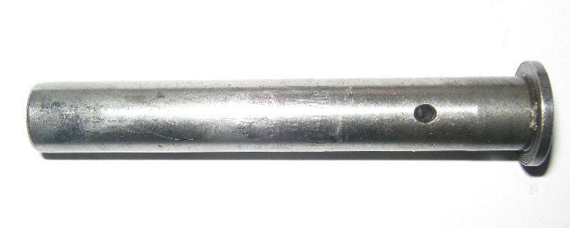

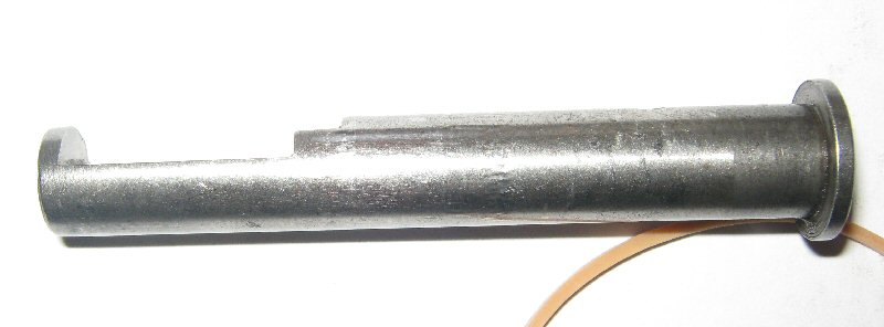

Ok found one on the spare motor, seems someone had turned it into a manual tensioner as there was a section of aluminium welded to the top with a bolt threaded into it and lock nut, took some photos, your right there are grooves, can see them under the flash and feel them, if you want the rod let me know, is that what your after ??
