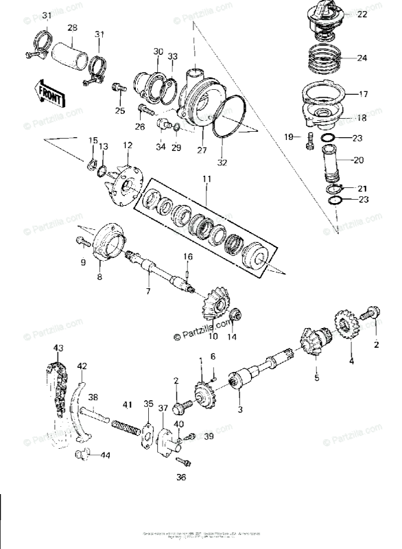

Looking at the diagram copied from Partzilla, you need to remove the mechanical seal retainer item #8 from the cylinder head and you should be able to drive out the mechanical seal from the retainer from the back side. Be CAREFUL how you support the retainer and don't crack it in half. And you're right, the PO glued it in place so I would consider heating it up a bit first to breakdown the glue before attempting to drive out the seal.

I have a bad habit of thinking I know how to do sh#t. Then I followup up by overthinking what I think I know when in reality I don't know sh*t!
Soooo, remembering my favorite nuclear procedure writers mantra, RTFM!
