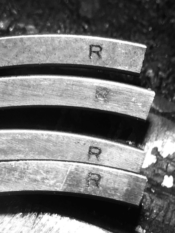

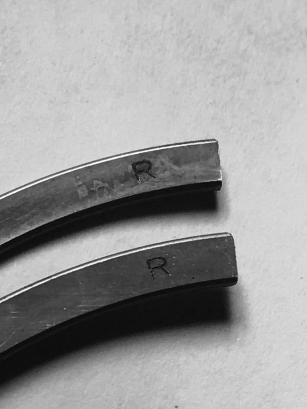

I've got the engine parts back from the machine shop and went to install the new "Cruzinimage" rings and have an issue.
The oil-rings - no concern. It's differentiating between the top two. Both marked with an "R" for this-side-up. One is marked with red.... and this is my problem. Both of these top rings appear to have an identical profile (under magnification). There is no reference as to which position this "red' ring is to be in,

As a rule, the top ring would have more chrome , be thicker measuring from the ID/OD dimension and thinner in thickness top to bottom. Most of the time I've seen the top ring indicated with paint, usually white but sometimes red.

Is it a trick of the light, or is the painted ring a brighter finish? If so, that likely bears out what Kawboy said about the chrome on the top ring.

That adds to the dilemma kawboy. Both are identical in measurement. I ordered the rings some time ago and immediately emailed "Crusinimage" asking for some clarity. No response. it's been several days now since my most recent inquiry and still no answer. Again; How hard would it be to indicate this with a red dot on the diagram ?
As for Material difference? I can see none. The only thing that differentiates the two is the RED marking on one of the rings.

Something else I noticed. The "R" notations on the two top rings have been hand engraved ! Not impressed.
