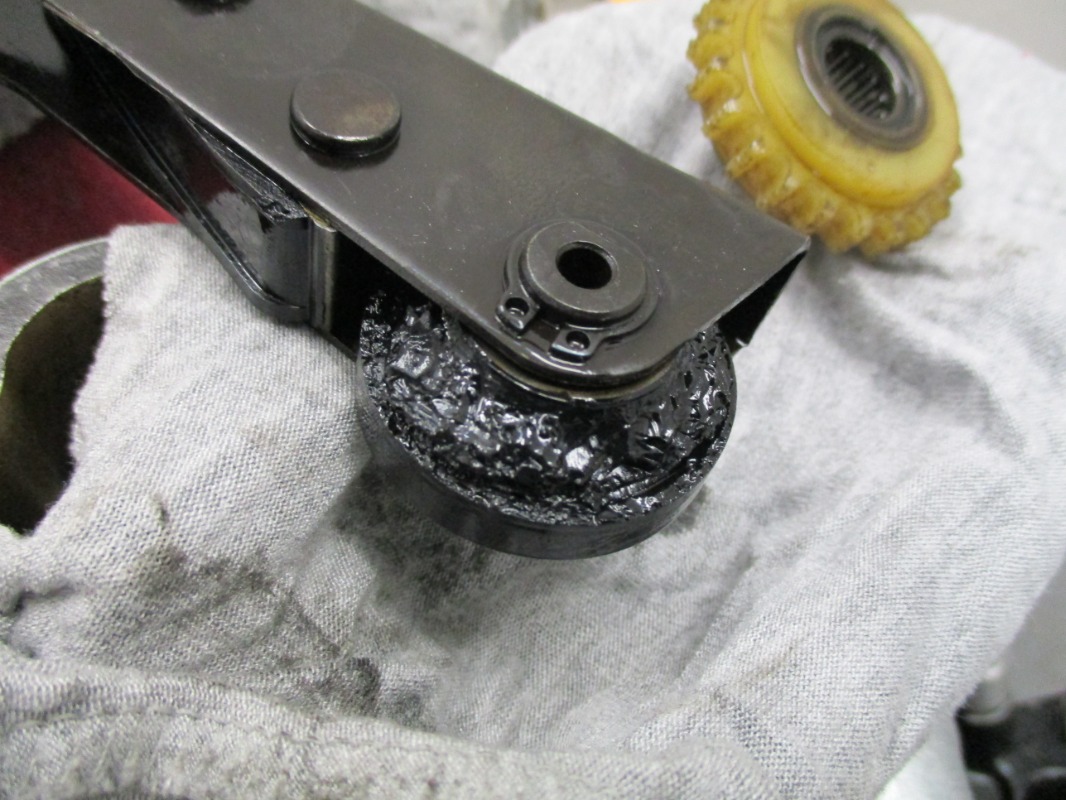

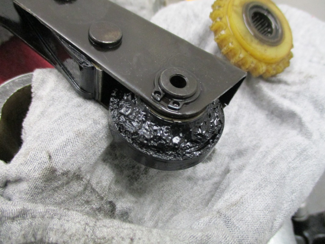

I didn't think of what could happen if a locked tensioner meets disintegrated rubber. I might have to look at the ZZR tensioner again. Coupled with the lighter spring could be great! It was always the higher spring pressure on the nylon/rubber that worried me.
As you can see my rubber wheel didn't fare so well..
SO AS YOU CAN SEE FROM ABOVE................A LOCKED OR UNSPRUNG TENSIONER FITTED HERE WOULD HAVE ALLOWED THE CAM CHAIN TO BE DANGEROUSLY LOOSE WHEN THIS HAPPENS RESULTING IN MASSIVE ENGINE DAMAGE.......FACT.
FAR LESS........ OR NO LIKELYHOOD OF THIS HAPPENING WITH A SPRING TENSIONER AS IT WOULD AT LEAST TAKE UP MOST OR IF NOT ALL OF THE CHAIN SLACK.
NO ARGUMENT THERE....................JUST 100% FACT.............SPRING TENSIONERS ARE DEFINITELY SAFER.
