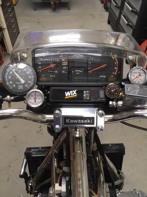

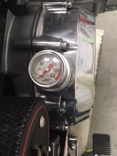

Keeping mind: I wasn't planning on selling this - I none-the-less wanted to determine the effectiveness. I measured air-temp with a high-quality thermometer, a PSI gauge and an oil temp. gauge. The gauges were checked against known accurate instruments and determined to be true.
The WIX sticker is a simple reminder that there is currently no oil in the engine.
The left small gauge is for fork air pressure to answer a possible question.

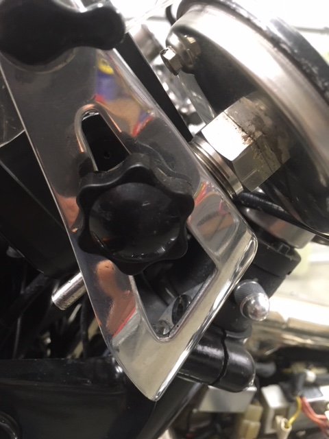

The air temp gauge was initially designed to be temporary using a thumb-nut to secure and easily remove it. it's been interesting enough to monitor the air temp that I have left it installed.
