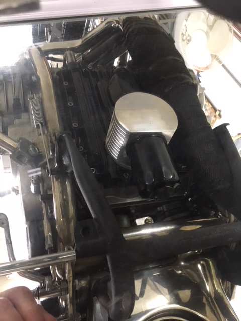

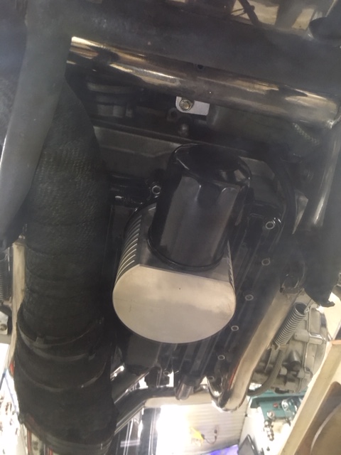

No oil is left in the cartridge well or adapter.
Adapter fits in place of the cartridge cover
No issues with the DG
I had previously removed the smaller (upper) center-stand brace but there is 2.5" clearance from the end of the filter to the lower (larger) brace. This accounts for the swing-up of the center-stand.
Can not confirm this will work with a stock exhaust as I've had the DG for 28(?) years. The resonators on the stock exhaust might conflict.
If someone with a stock exhaust could take some measurements - specifically the space between the resonators - this will help confirm.
Filter: Dia. 2.475 Length - 3.4"
Will talk to the "shop" to confirm the price.

If the oil filter Part# is the same for both pans then there should be no issues. The adapter is well above the lowest point of the header.
I just talked the shop owner and he's going to get a price per piece based on a "low # production run" of 12, early next week.
Would appreciate some measurements/photos of a Deep-Pan, preferably off the bike, for clarification to Stan's query. I have no idea how the deep-pan was made/cast/machined, relative to the oil filter.
