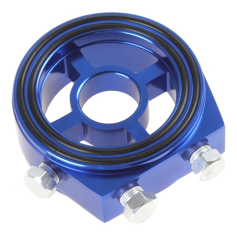

Scotch, the type of sandwich plate I had in mind is a simple one, to use only on spin-on filters, like you have now. Is it also how you understood what I said?
Here is a link:
Oil-filter-block-Adaptor-Sandwich-Plate-for-pressure-temperature-sensor-gauge
This is exactly what I bought for the Vmax, but still haven't used it. My idea was to attach this now and you could run pressure or temperature gauges directly from the filter. If not permanently, perhaps for research? It's just about $12, and I am going to do it this summer.
Here is a link:
