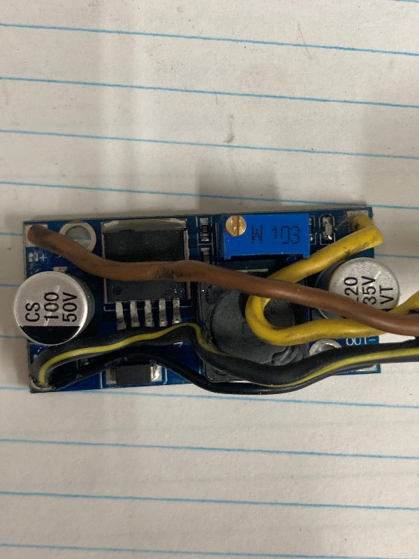

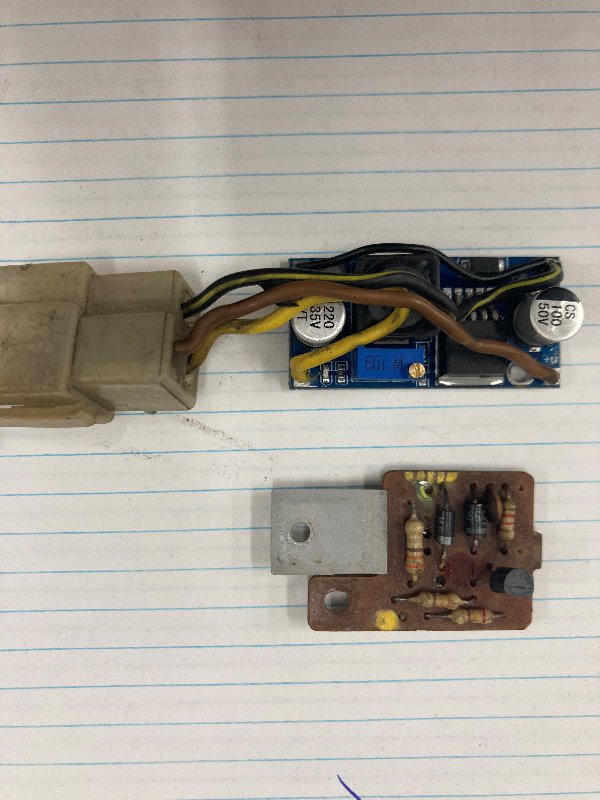

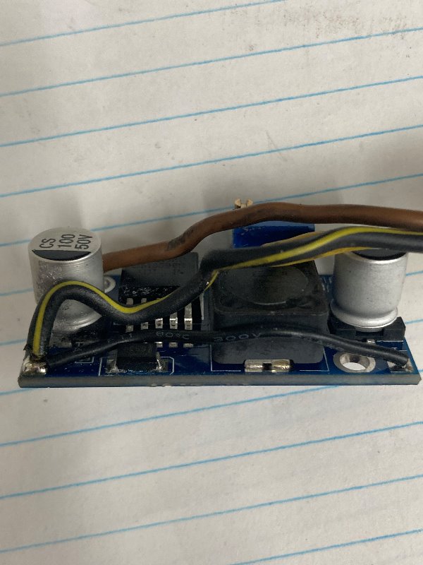

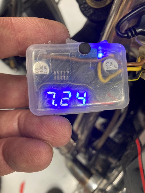

The rated values of the components in my instruments Voltage Reducer have changed from age and heat causing the fuel and temp. gauges to read slightly low. A FULL tank was reading 7/8. The Temp. was reading "cooler" then it should as determined by when the Fan came on
Couldn't adjust the fuel sending unit any further and wasn't interested in recalibrating the gauges as the trend would continue.

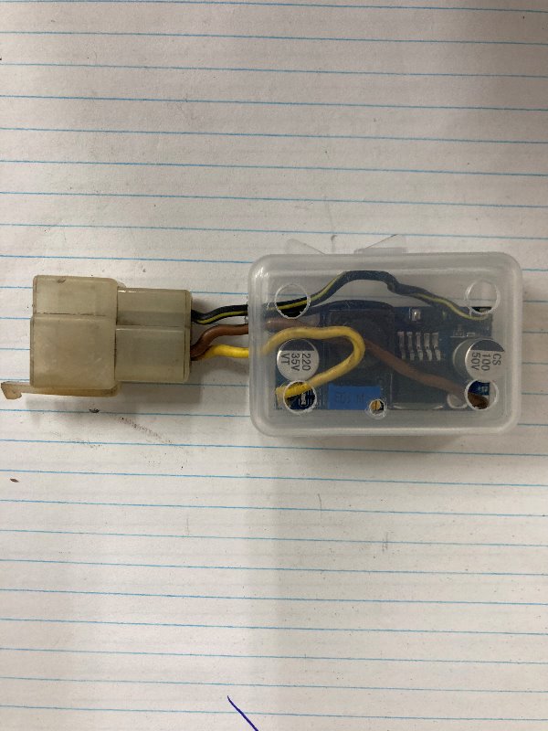

Attaching a voltmeter I had was easier then trying to hold probes while adjusting the output and as it turned out everything fit into the container.....so left it as is. It tucks away neatly.
Now reads Full / Empty / Reserve correctly. Same for the Temp. gauge.

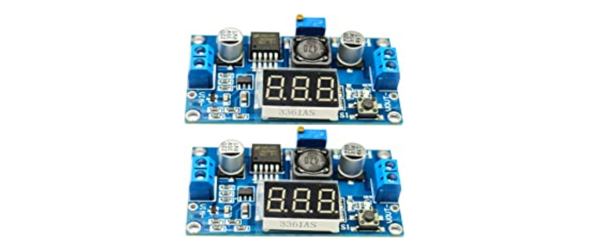

Great info. thanks Scotch. Amazon now has the LM2596 buck converter with an included LED Display that can be switched to show input voltage or output voltage, or led display off. 2 units for $13.99/ got to like that !!

Good stuff !
NOTE from supplier: "Some customers report that the output voltage of the module cannot be adjusted and is always equal to the input voltage. When you encounter this kind of problem, please turn the potentiometer counterclockwise for more than 10 turns, and then use the module to adjust the voltage normally
.Rotate clockwise, the voltage increases. Turning counterclockwise, the voltage decreases."
Adjust to 7 volts prior to installing or there's a risk of damaging/ruining your meters with full battery voltage.
Then adjust as required.

- Posts: 3297
Re: Instrument Voltage reducer
4 years 2 months ago - 4 years 2 months agoGood advice. makes sense.scotch wrote:
