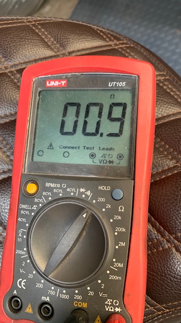

Right, back from the show, did some checks.
All the connectors and wires in the entire system seemed undamaged, not melted, not corroded.
There was no continuity between any of the yellow wires and the frame.
I do not have a 1 Ohm meter, but at 200 Ohm this was the reading for each of the three yellow wires:
Doesn't mean much I guess..but it was consistent between all of the wires.
Then I ran the engine at 4000 rpm and there was 31V coming out of each of the yellow wires. According to the manual that is too low by 20V.
Then I connected the regulator and ran the engine at 4000 rpm, and virtually no volts came out of the positive pin coming out of the regulator.
So either the voltage going in to the regulator is too low for any volts to come out, meaning the stator is kaput, or 31V is enough going in and regulator is kaput.
Thoughts?

The resistance measured is within spec, so that leads me to believe that your voltage check was not done as per manual. The output of the stator is +50V AC between 2 of the yellow leads and to do the test measure between lead #1 and #2, between #2 and #3 and between #3 and #1. ( Note that you can name the leads as you see fit) The point is that you need to check the output between each of the 3 leads to the other leads. I'm going to suggest that maybe you had the volt meter on DC or you were checking the output of each lead between the lead and ground??
