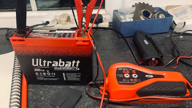

Hi, here is my battery.
It seems OK and the fuse is fine, but I will contact them to see what they think. It charges nicely on the special charger I have for it, but discharges slowly when I'm riding, mainly due to the headlight..
I hooked the bike up to an ordinary car battery and that seems to charge fine, volts going up with revs. But on bike doesn't.... mystery!
