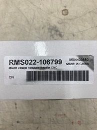

Regarding the mentioned "RM Stators' Red CNC Regulator" I'm reposting this correspondence with R.M. Stator:
The history: I ordered R.M. Stator's RED C.N.C. regulator on May22/21 ($187.94 cdn.) 1 month later I became concerned about the output which had changed from an acceptable 14.7V to 15.7V. Shortly thereafter the voltage was all over from 12V to 16V. I contacted R.M and they requested some info regarding the alternators continuity and A.C. output. No "opens", No "Shorts" and a healthy 70VAC @ 4000RPM.Multiple tests for load and resistance on each of my fused circuits eliminated any doubts about wiring problems. They authorized a return c/w a prepaid shipping label and sent a replacement.Less than 2 months later - The same issue!I again contacted them, assuring them that there was nothing wrong with my wiring. An obvious and logical question!Again, they authorized a replacement (#3) I contacted R.M and advised them that because #3 arrived late in the season (2022 only 2 weeks remaining on insurance) I would not open the package until the beginning of the riding season 2023. They acknowledged this!In early April '23, I installed #3. An hour later I wrote the followings to R.M.: Re: Invoice# 101002675/transaction# 3PL00671SBO131541 I am writing to inform you that the 3rd regulator is defective; right out of the box! It charges at 15.1 volts, contrary to your own specs as found on your site diagnostics info. I have once again installed my Shindengen 847 - 14.7volts max. I am respectfully requesting a refund as I have no confidence in this regulator.
Their response:
Thank you for contacting us!
As mentioned in our Return and Warranty policies on our website, refunds are only available within the first 90 days of purchase for new and unused parts.
Unfortunately, we will not be able to assist with your request due to the elapsed time frame.
We appreciate your understanding and hope to do business with you in the future!
My response to this:
"Are you freakin’ kidding? 3 defective units in about one year – not one lasting more than 2 months and you are not going to give me a refund for a device that clearly has a component/design flaw! I’ll remind you that the Shendengen 847 is AGAIN back in my bike and continues to operate without issue or concern for almost 3 years. It was my back-up while I dealt with your regulators, but is now my permanent regulator.
From your Web-site:
."We always make it right if your expectations are not met. ?. At our core, we strongly believe in The RMSTATOR Way. ?. This philosophy makes us elevate our work to provide a frictionless experience to our customers and the most comprehensive customer service support in the industry?.
Might I remind you that the 3rd reg. you sent me was received late last summer, within weeks of the bikes insurance expiring. I contacted you and advised that I would not open the package until the start of the ’23 season…… and you acknowledged this!So now, at the start of this 2023 season this third regulator is overcharging; right out the box and you are hanging me out to dry on a “Warranty”/90 Day return policy “technicality”? I’ll kindly ask that you reconsider, given this specific case and refund my original purchase price. I am a “Sustaining” member of the KZ1300USA forum and a frequent contributor (“scotch”) as well as other forums. To date, I have not said a word about this issue with this regulator, on any Forum. That could change!
Pissed-off and disgusted!"
I received a full refund!
In my humble opinion - which I expressed - "This unit has a serious design/component issue". (Most likely a Factory “Substituted/Alternative" component.) Regardless - "3 consecutive failures".
If you are considering an upgrade - Buy the Shendengen 847 ! The Shendengen 847 operates all day - literally - at 14.5V ! Over 13V at idle !
You can come to your own conclusion(s)

I'll agree with Scotch here. the Shindengen 847 is an awesome regulator and there's been no reports of failure unlike the RM Stator 50amp series regulator. One caution though. there are several counterfeit versions of the SH847 out there, especially on EBay.
Roadster Cycle
is a trusted source for the SH847 and as far as I know, is the only official importer for the SH847 for North America.
Regulator failure modes
Diodes can fail open or closed. Failed open and that phase attached to the diode will not add to the charge of that phase. The charging output if measured will be lower by one third for each open phase. (approximately) Failed closed and the phase is shorted causing a drain on the charging circuit which will result in a dead battery.
Regulator transistors can also fail open or closed. Failed open and there's no output from the generator charging the system. Failed closed and again, a short in the circuit causing the battery to go dead.
