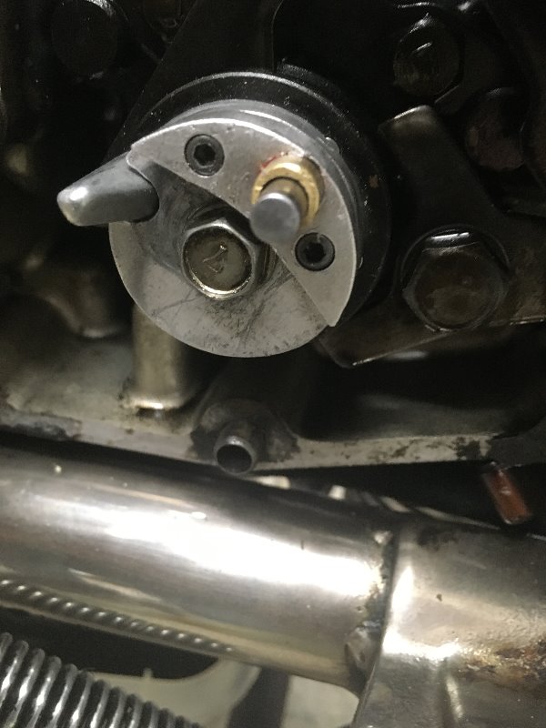

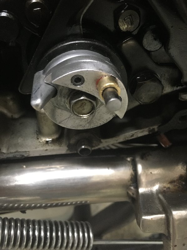

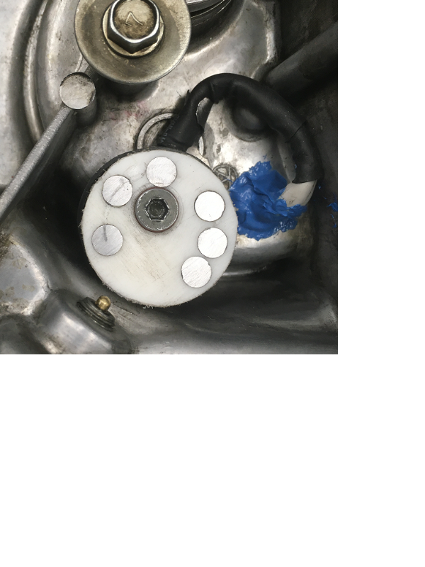

I made the two key components. A spring-loaded contact that mounts to the "Pin Holder" (a completely misleading name) and a multiple contact plate (a stator) that's mounted to the inside of the shifter cover.
Some reading-up on the "universal" type (using a magnet between two reed-switches) exposed a common complaint regarding misreading's. Plus, I didn't want this "garbage" anywhere on the outside.

Thanks for sharing. Looks like something I would like to try on my hobby CNC.
Did you have or still have some contact? Looks like there is some rotational scaring
My spring-loaded contact has 7mm of travel. The distance to the stator has the contact 1/2 way through this range of travel. The "scaring" (Ouch !) is actually the ink from a felt-pen that was applied to the contact to confirm a concentric position.
I've since "cleaned-up" the parts - not that they'll be seen.
