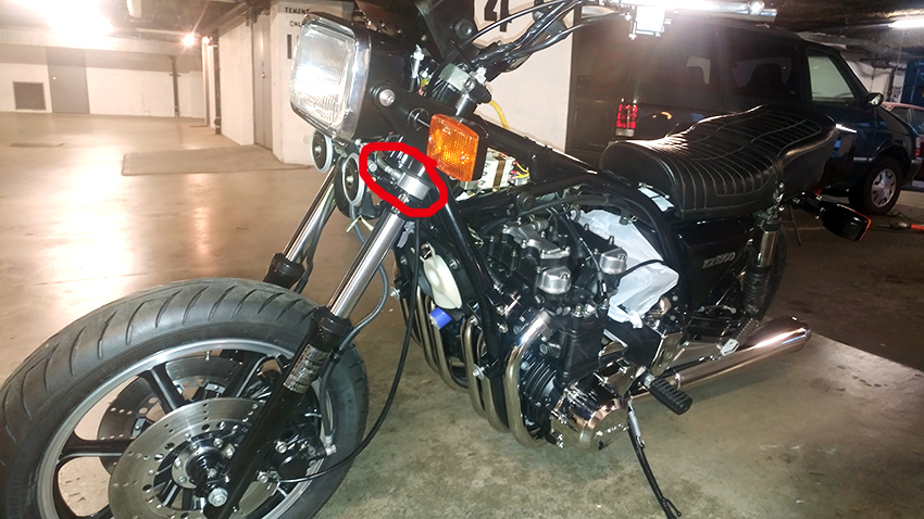

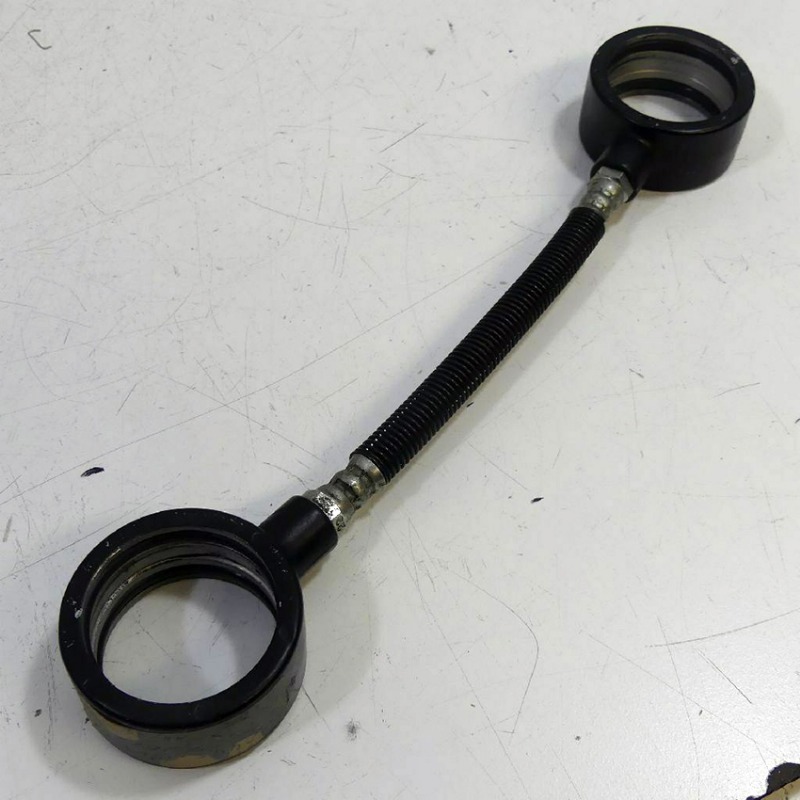

I'm surprised it wasn't said sooner that both forks are linked.
Here a couple of old photos of it on my bike.
Currently one available on Ebay.
Kawasaki Z 1300 Air Support 51044-1005

51044-1005 " Hose Assembly, Front Fork" used on
Kawasaki Motorcycle 1982 KZ1300-A4 Front Fork
Kawasaki Motorcycle 1979 KZ1300-A1 FRONT FORK (KZ1300-A3)
Kawasaki Motorcycle 1981 KZ1300-A3 FRONT FORK (KZ1300-A3)
Kawasaki Motorcycle 1980 KZ1300-A2 FRONT FORK (KZ1300-A3)
info provided via www.partzilla.com/product/kawasaki/51044...539a052ba030fc7c3b32

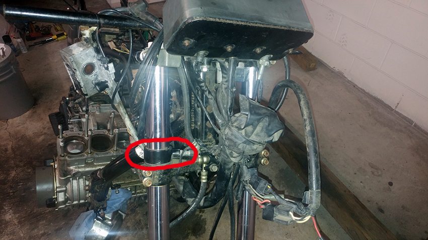

Re: A5 refurb
7 years 5 months ago
tha nks all
it seem all years have differing set ups.
mine is a 1984 a5. it has only one valve on the left fork top.
there is a balance pipe at the bottom of the headlight bracket so air pumped into the valve stabilises through both legs.
in all pictures it shows this pipe as a standard rubber one as in brake pipe.
mine is a much thinner solid pipe!!!
as long as it works though eh.
thanks for all comments. really enjoying finding this stuff out.
