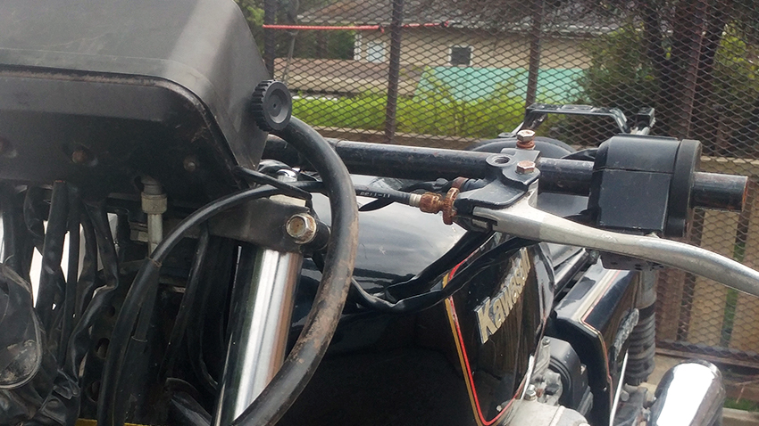

Stan. any chance you can send me a close up of your clutch lever and the mounting. i am trying to establish bits which have been changed on mine. what i have at present if not right.
Tad
Re: A5 refurb
Last edit: 7 years 4 months ago by StanG.
The following user(s) said Thank You: Tad
