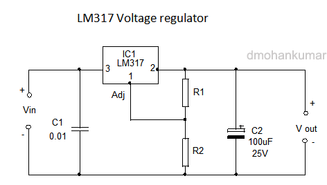

Yup ! It was me. Seems everything else has been covered so per "the Bible", check the voltage output of the instrument voltage regulator.
It's a simple circuit. This is a similar schematic:
If it checks-out, test the temp. gauge sender.

scotch wrote: I'm hoping that I'm not having a senior's moment but I also have it in the back of my mind that Scotch came across this some time ago.
As I understand it, the job of that voltage regulator is to supply a constant & stable 7 volts DC, irrespective of battery voltage, to the fuel & temperature gauges, so that the needles don't move with the constantly changing battery voltage?

Interesting thought on instrument cluster voltage regulator. I noticed yesterday my system voltage ramped from 12.0 to 14.9, apparently randomly, as not into the fan, or knowingly adding additional load. So charging will be next. This bike has dual alternator setup. Of note to is I connected to a brown wire near headlight for voltage sampling. Will move it directly to battery after procuring appropriate connectors and cabling.
I assume the regulator is in the instrument cluster? Off to the FSM and Thank You!

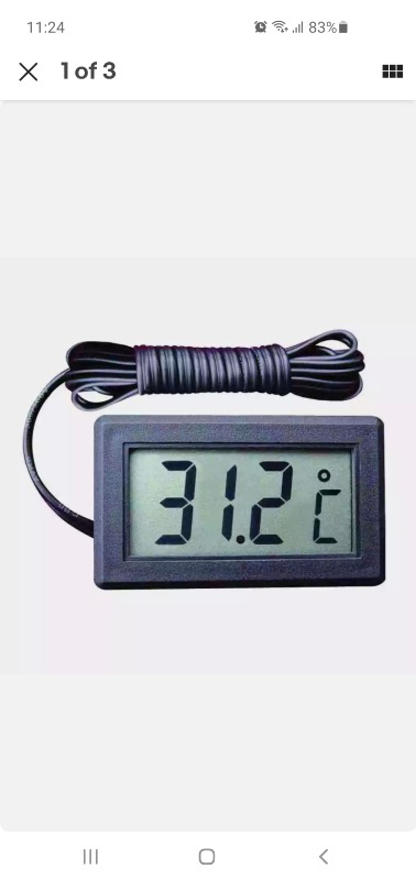

Stiggy wrote: I haven't had cooling issues but I temporarily fitted a cheap digital temperature indicator as a cross check. They are cheap but accurate enough for this purpose. Lots on fleabay. They have internal battery so no wiring needed.
Here's the item number of the one I got. 274386235926. Beware some similar looking only go to 70 deg c.
Most i ever saw was 89 deg c in traffic but usually about 86 at mach 1.
Note... mine is a UK ZG1300 DFI.
I used a blob of silicone sealant to attach the sensor to the coolant outlet, then added a piece of insulation about 2 x 2 inches to prevent any false reading due to air cooling.
Great idea! You know, IIRC I have some T/C wire and a T/C portable reader.. Off to the drawers!
